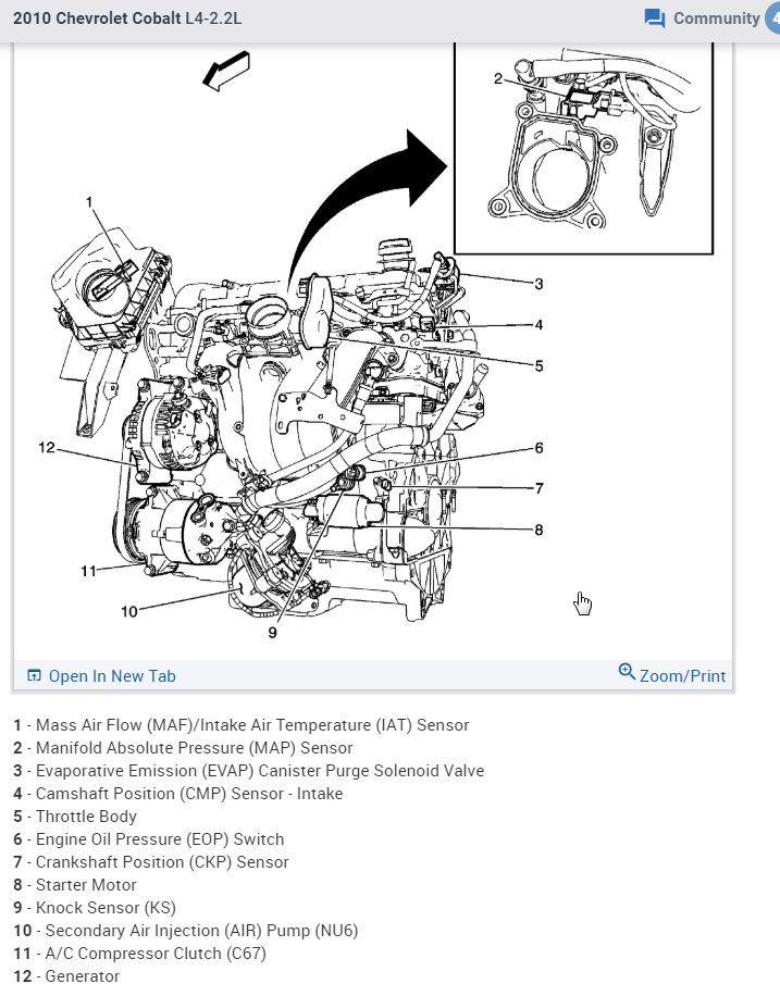

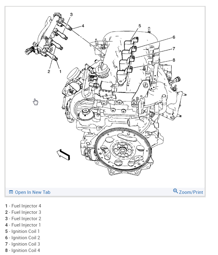

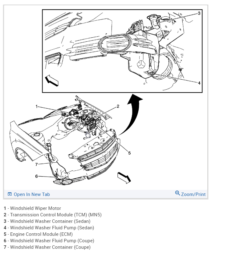

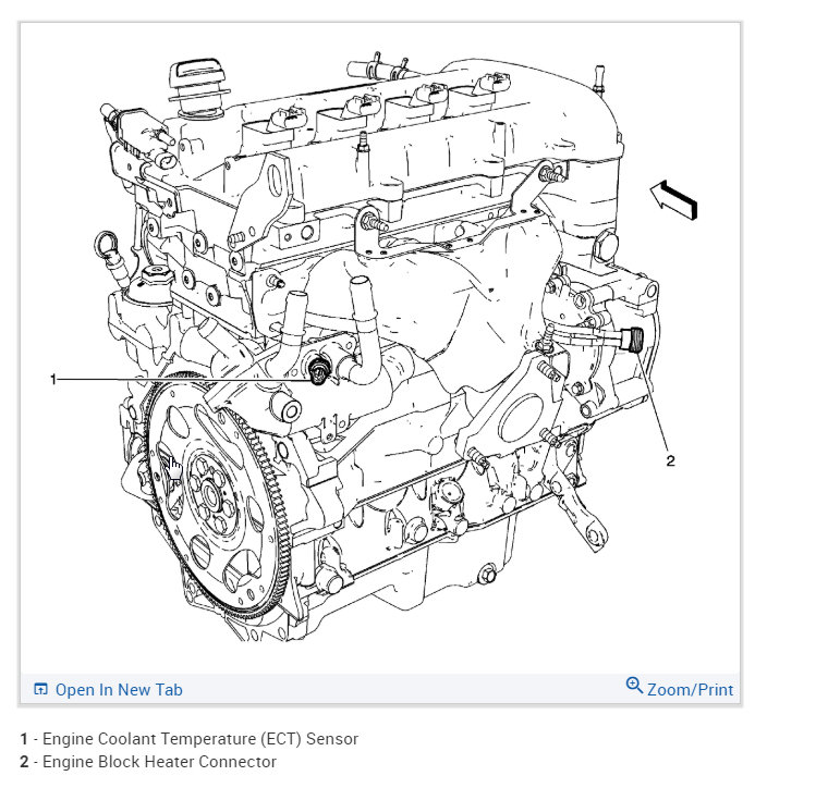

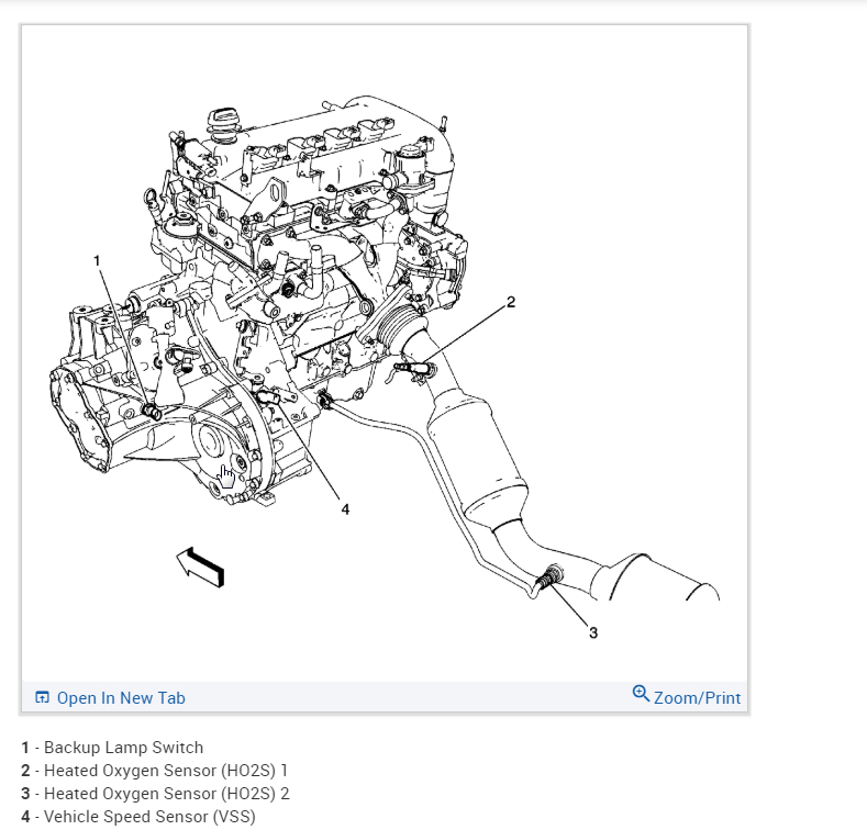

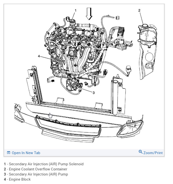

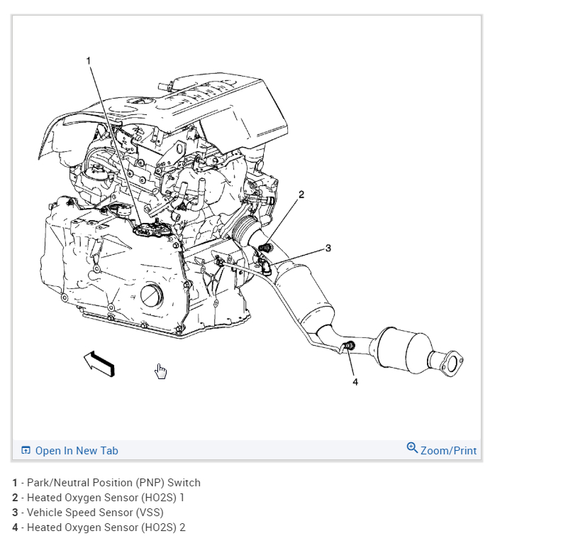

I need a diagram of the component locations on my car. Like where the O² sensor, TCM, cam, etc.

Hi DUWHOP,
Looks like this includes everything power-train related. Check out the diagrams (Below). Please let us know if you need anything else to get the problem fixed. Please let me know if you need other items. Thanks
