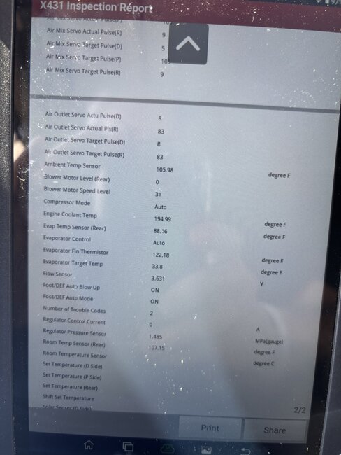

Cousin had an issue with his Sienna, I took it to this guy who has a recovery machine and knows more than I do. I suspected the compressor is weak due to miles.It was randomly cold but mostly not cold. He said the compressor and kit, expansion valve needs to be changed. Cousin was on a budget so I got one from amazon and took it to him. He called and saids the new one is not coming on. He played with it and called next day said it's ready. I picked it up, freezing cold, got home and turned it off, took it to my cousin next day, super cold. He took it and 3 days later he said its blowing hot air. His brother has good knowledge on readings and the such. He said the flow sensor reading was 2.8 and is high so he got another one, now it would not cool at all. He got a used Denso compressor and it would not cool at all, flow sensor reading was high around 4, and based on Toyota guidelines the lower the better. he had a 12v signal and a 5v to the wires. He suspected the amplifier so he changed it, also changed the HVAC control unit on the dash same thing. Just called him he said he replaced the flow sensor from the new compressor I installed and installed it on the Denso compressor, not taking freon, he said sometimes he even loses the signal to the wire. He also changed the relay. Ever seen such a problem?

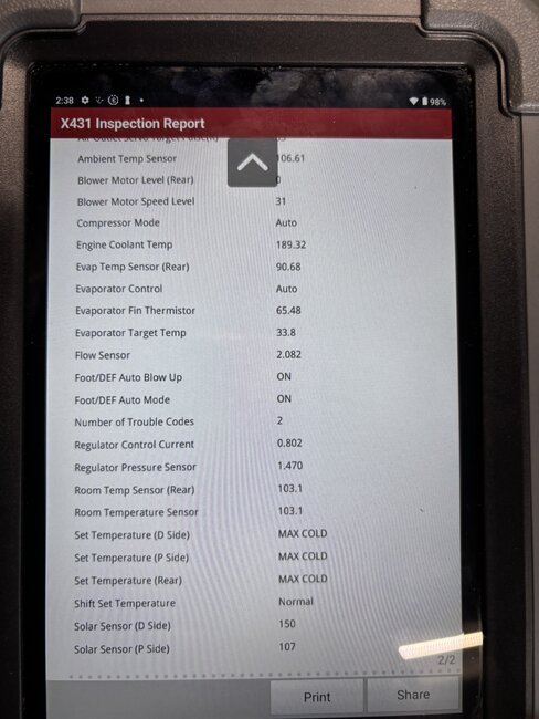

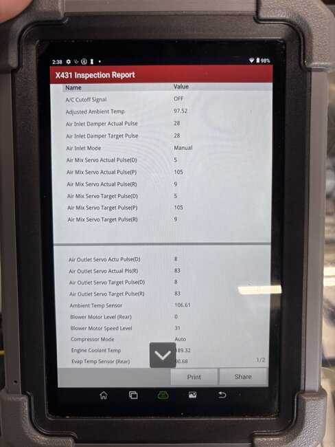

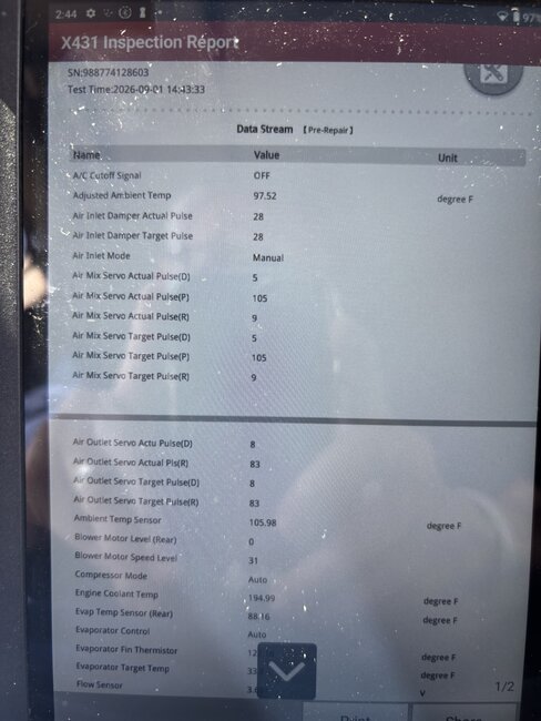

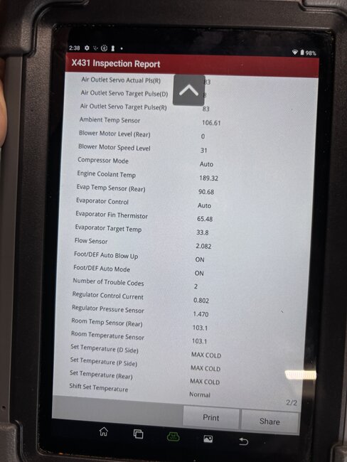

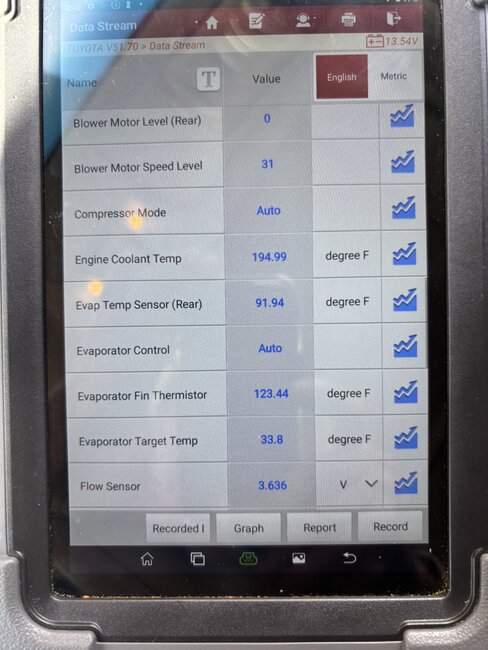

here are some of the readings he was checking

If the clutch does engage but the high and low pressures don't separate, then concentrate on the compressor control solenoid/variable displacement operation or the compressor itself. Toyota confirms that the solenoid determines compressor displacement and therefore pumping capacity.

Yep, there is a control solenoid that varies the amount of refrigerant availably to compress. I would do a CAN scan to see if any codes are in the system. Also, when the system is running what are the high and low side pressures?

Only code that always popped up was the compressor flow sensor even after it was replaced. When we installed new one all readings were fine on gauges. Where ia the control solenoid located?
