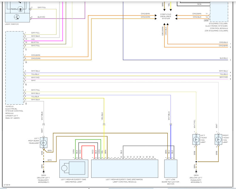

If the light assembly works on the opposite side and you have power on the passenger side, then it should work unless there is no ground. The two sides have different ground points.

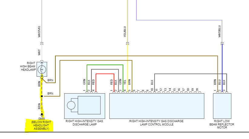

I attached a pic below showing the ground. It will be a brown wire. Confirm that the wire has continuity to ground.
When you check, make sure there is continuity at the connector at the lamp assembly.
Let me know what you find.

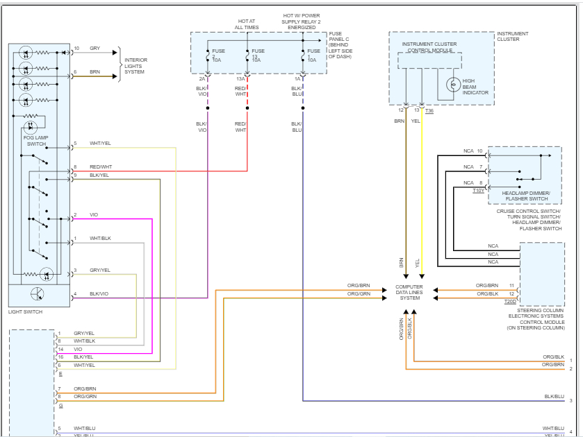

If you have power to the blue/white wire, that goes to the light module.
I'm looking at the wiring schematic. I attached it below for you, so you have a reference. It shows the low beam separately with a separate power supply. Is that what you are seeing?
Take a look at that, compare it to the vehicle, and let me know if I'm going crazy. LOL

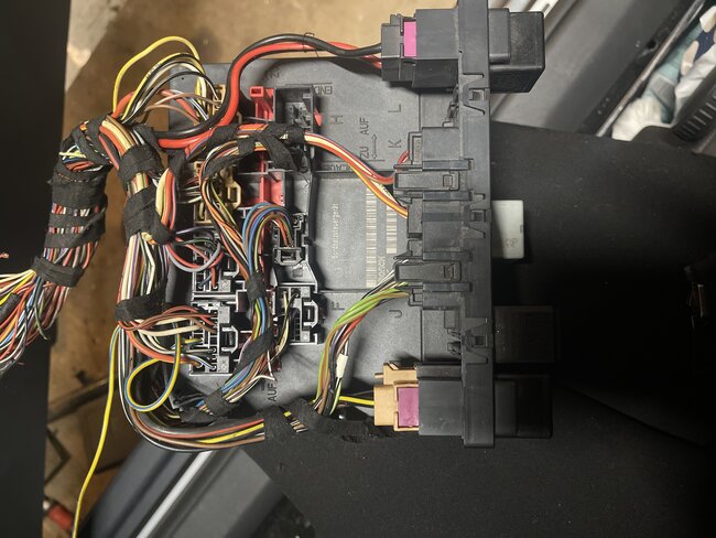

I’m not sure I’m following these pictures right but I can tell you that my car has 14 pin plugs and that the only bulb that gets power is the hid bulb and the 2 that are located in lower part of the assembly dipping/DRL and blinker, then there is a branch off of the harness on each side for marker light and fog lights my high beam and low beam are controlled by the shutter on the hid bulbs lens. so, it’s getting its power from the ballast. I believe once the igniter turns it on and the other bulb with the brown and white wire does not have power going to it at all unless the car is made and being driven in Canada or of course if you break the codes and program them to be on yourself which I have not done so.
I can tell you that the wire that shows the 12 v in the harness on both L and R h.a.plug travels to the communication board under the dash on driver side and it’s in the plug that goes to A. (Pic of board below).

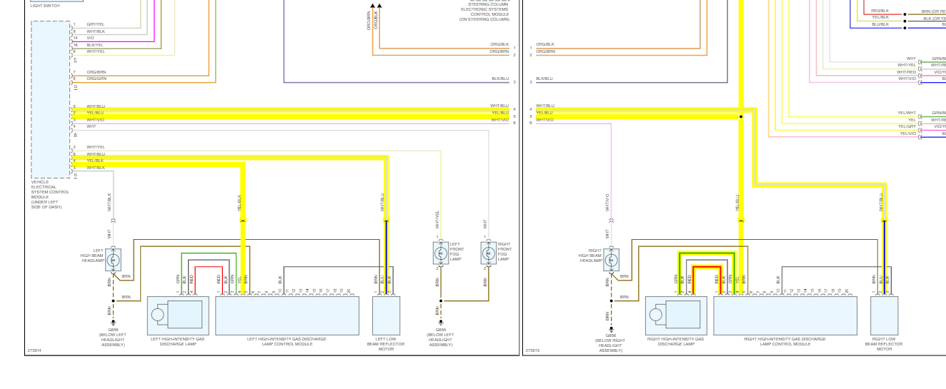

What color are the wires you are getting power on? Looking at the schematic, the left and right lamps have different power sources or at least different connectors. One is connector A and the other is connector D.
See pic below.

I’m going to go back and recheck the volts I’m getting anything on, but I know for sure the yellow/blue I get full 12+volts and that is the only pin in any of the headlight harnesses to read full voltage with lights on and both car in on or started and running with or without parking brake on. If I do know that the pin next to the yellow and blue on car side gets between 4-and 5 volts reading but that’s it and there maybe 1 other pin with low volt reading also. What I'm not understanding is that according to this image it’s showing the driver's side wiring to be using yellow/blue to power both the ballast which in turn powers the igniter and we know indeed is working but on passenger side for some reason it’s only using the yellow/blue wire to power the hid shutter which is actually low beam and then using a I think yellow n black wire to send power to the ballast which would then go to igniter but it’s never going to happen because it needs the initial jolt of high bolts to igniter then once lite is only using 3-5 volts to stay lite and storing rest in the ballast. So, I’m not getting why one side is changing its wiring pattern and wondering if that’s why my lights are not working can I add the yellow/blue wire to the pin where it’s trying to use the yellow/black?
