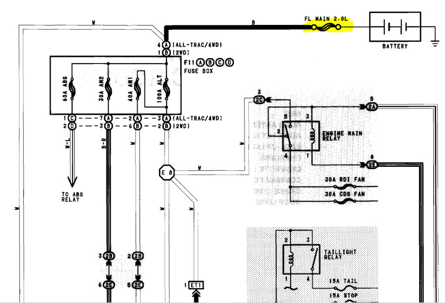

While driving down the road, my car had a complete loss of electrical systems. No dash lights, no instrument panel, nothing. I can still shift in and out of neutral. Battery tested fine, a little corrosion on the terminals that were cleaned but still no go. I’m not sure about the fuse blocks because I believe they are custom, but I know I have power running to them. The person who owned the vehicle before me did not take the best care of it.

Because of the model year, I was only able to find an old OEM power distribution schematic. From what I see, there is an inline fuse between the battery and the fuse box. Take a look at pic 1. Check to see if there is power passing through that fuse.

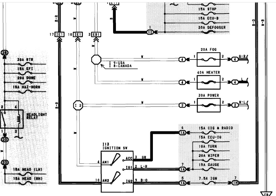

Also, I attached the entire power distribution schematic below for the vehicle, so you have a reference.
Let me know what you find. Also, let me know if anything electric works. For example, the horn, headlamps, and so on.

Since absolutely nothing worked, follow the wire from the battery and see which box it goes to first. The problem has to be before everything starts distributing power. Otherwise, something would work.

So, apparently, I was wrong. I’m not even getting power to the fuse box. I completely forgot to take pictures though I’m not sure how it would help. Brand new battery, terminal is fine, cables seem to be in good condition.

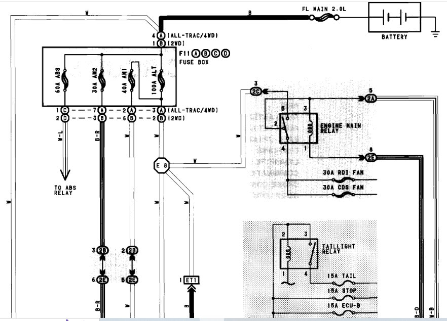

If you have a chance, take a few pics. I have no idea how this was rewired. Also, there should be a power supply from the battery to the fuse box. Locate that and inspect it. Something must have failed between the two locations.
Take a look at the pics I attached above. On the 2.0L, there is a primary fuse between the battery and the fuse box. I suspect that is what has failed.
