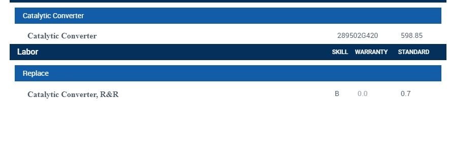

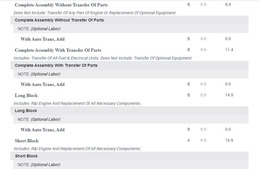

Could you help me out with the AllData or equivalent to 2012 Hyundai Sonata complete engine replacement with complete transfer of parts, cleaning the intake man. Also the remove and repair for the catalytic converter?
Thanks so much.
Victoria Margaret
Mar 5, 2020 at 10:48 PM
Good morning,
I attached the prices you requested below for the labor times.
