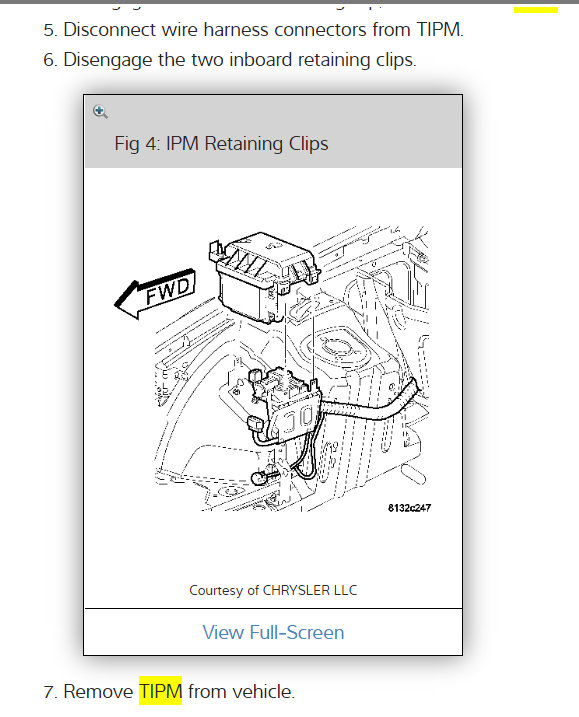

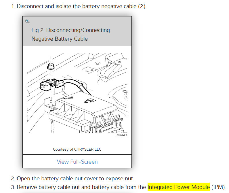

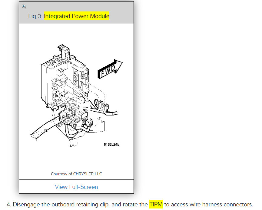

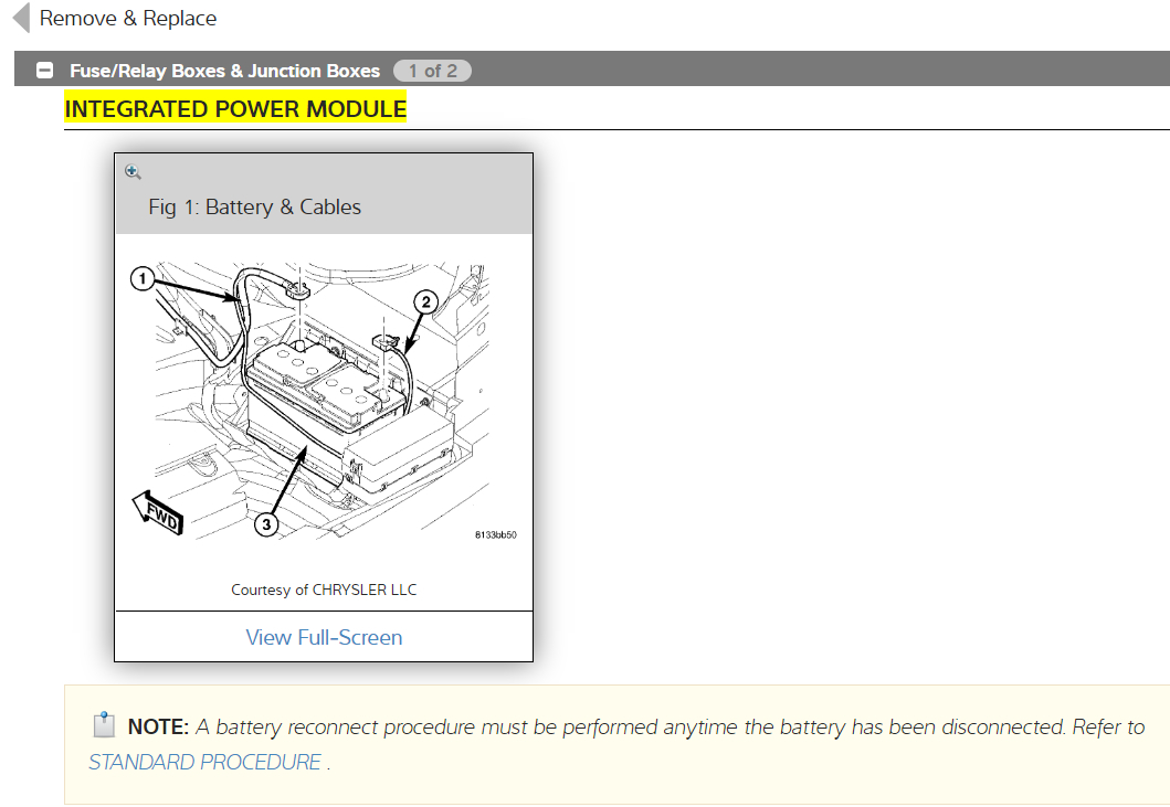

Yep, this happens when the cables are reversed it takes out the car's TIPM which are weak to begin with. We can confirm if you can do a CAN. You can get a CAN scanner from Amazon for about $30.00. here is a video to show you how. I have included the TIPM replacement instructions in the diagrams below, it is easy to replace it because the unit self initializes.

No, I would not reconnect the battery until the TIPM is replaced, something is shorted causing the heat, you might want to try disconnecting the TIPM and do the test again to see what happens.
