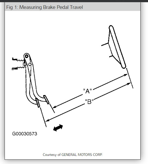

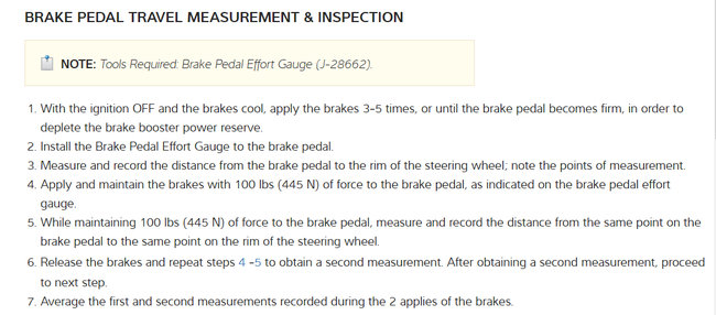

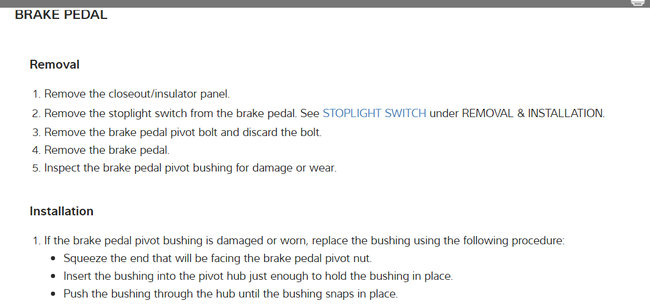

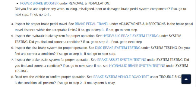

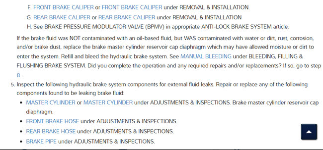

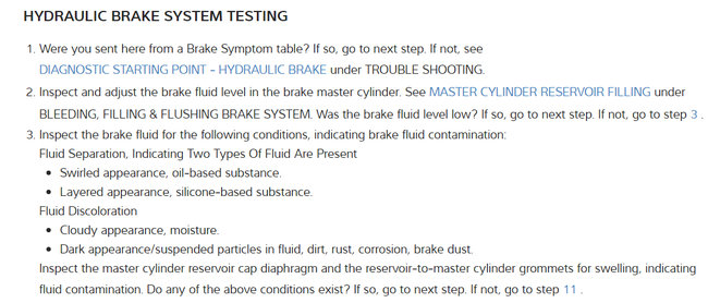

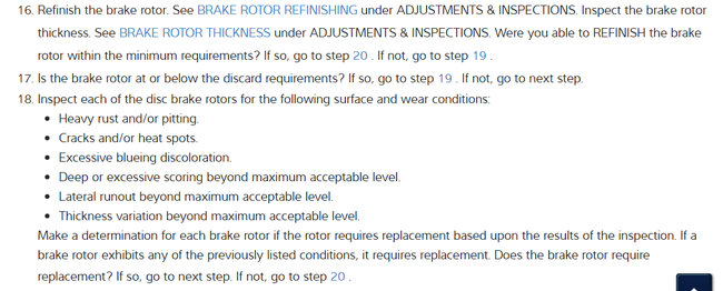

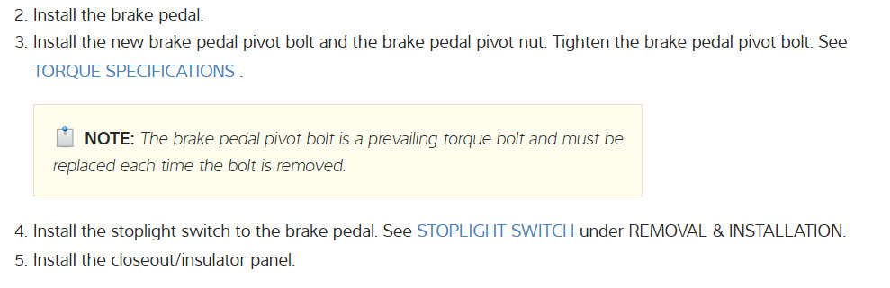

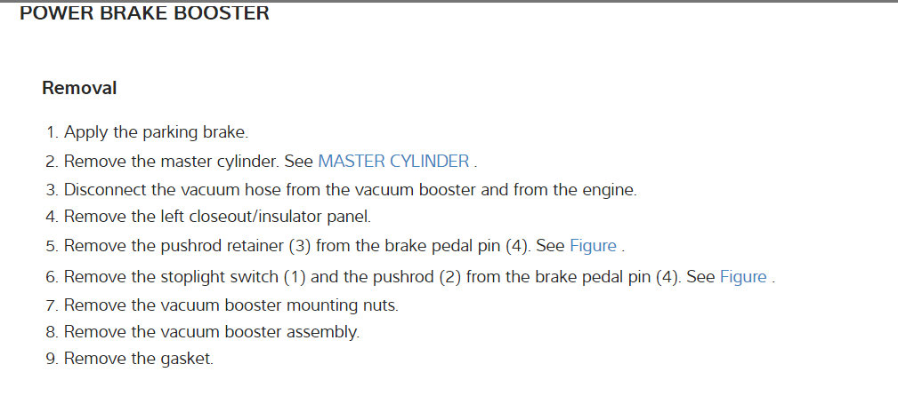

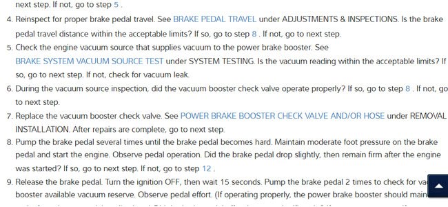

I have a pedal that goes to floor when the engine is running. I have replaced master cylinder, ABS module, ABS modulator, all 4 calipers, brake booster. I have tried using a code scanner tool that has the ABS bleeding and the pedal is still going to the floor. I have bleed the brakes several times, used about 6 quarts of fluid. There a no leaks so run out of ideas
Apr 25, 2021 at 3:43 AM (Merged)

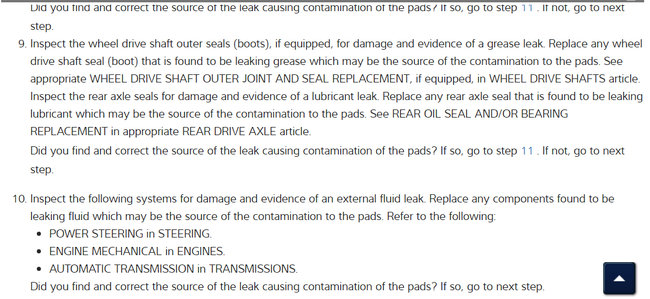

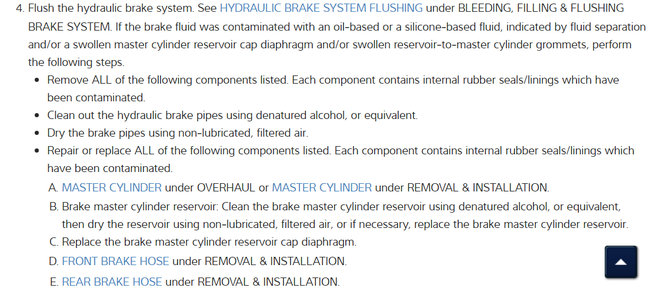

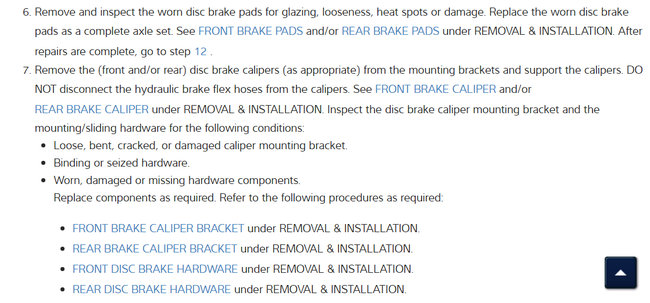

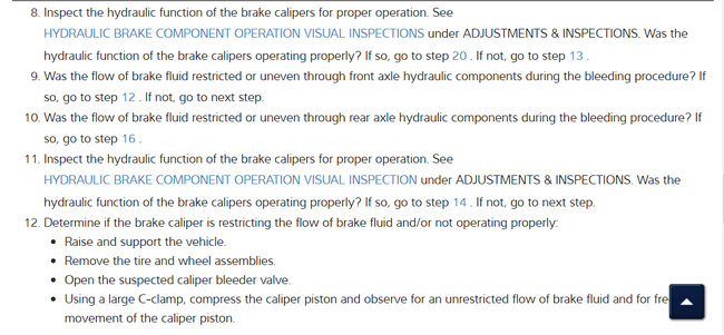

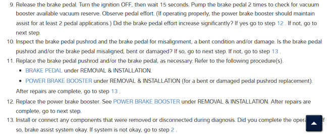

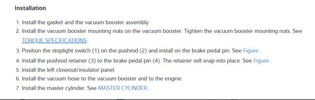

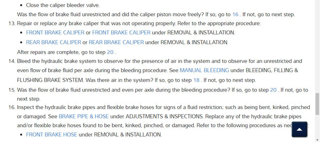

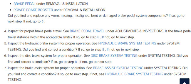

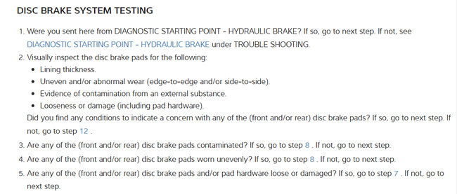

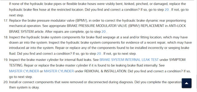

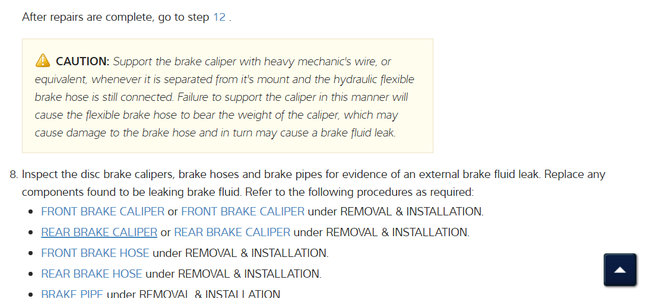

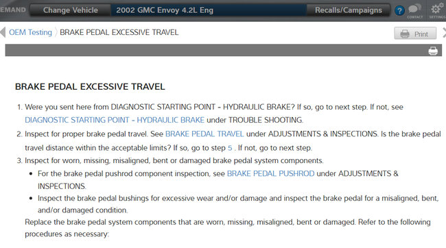

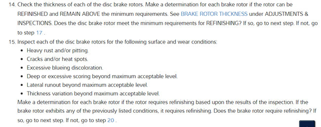

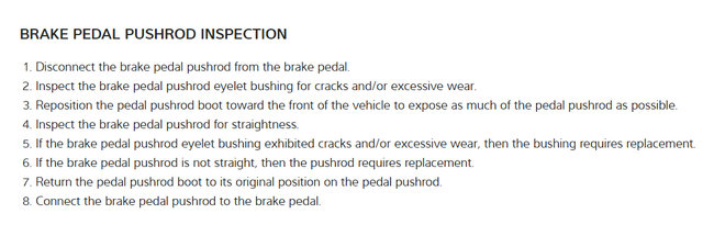

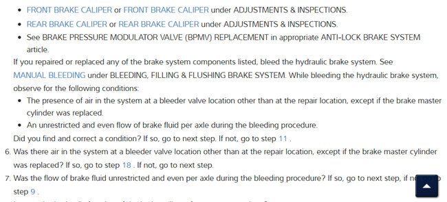

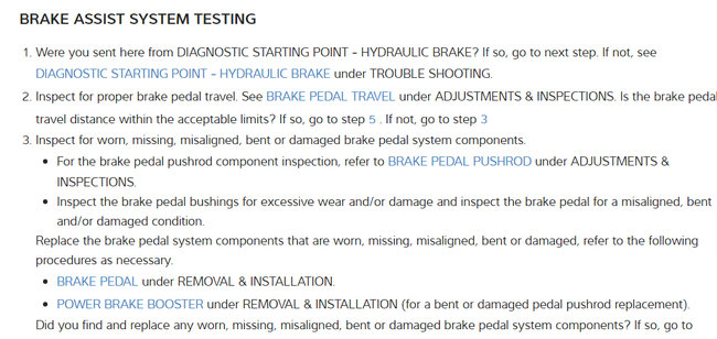

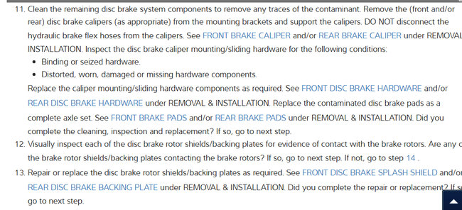

SCGRANTURISMO
  • 4,897 POSTS
In the diagrams down below I have included the factory diagnostic troubleshooting guide for excessive brake travel for your vehicle. It might appear to all over the map, but it is in order, and when it goes from one thing to another, you are meant to skip to that sub inspection. Please go through the guide, in order, and get back to us with what you are able to find out.
Thanks,
Alex
2CarPros
