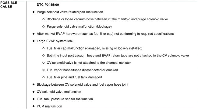

The code you listed indicate a leak or blockage. The first thing I would do is exactly what you are trying, smoke test. If no leaks are found, then we will break it down and start checking things. I attached a picture of possible causes of the code. Take a look through it and see if it helps.
Let me know what you find.
