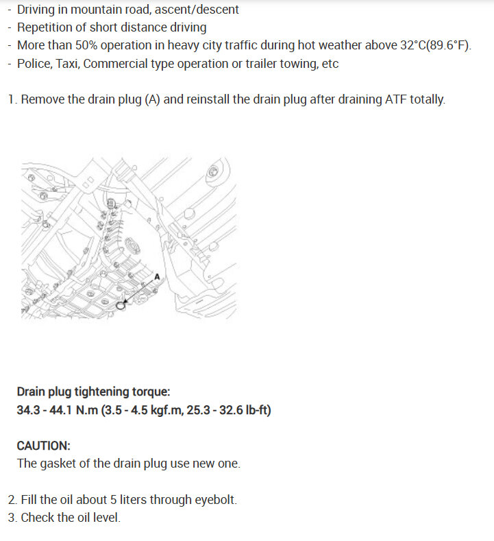

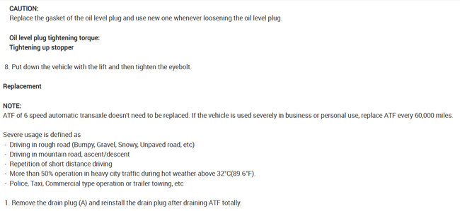

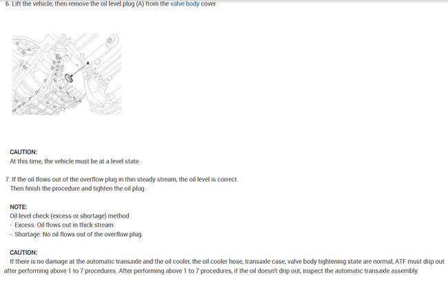

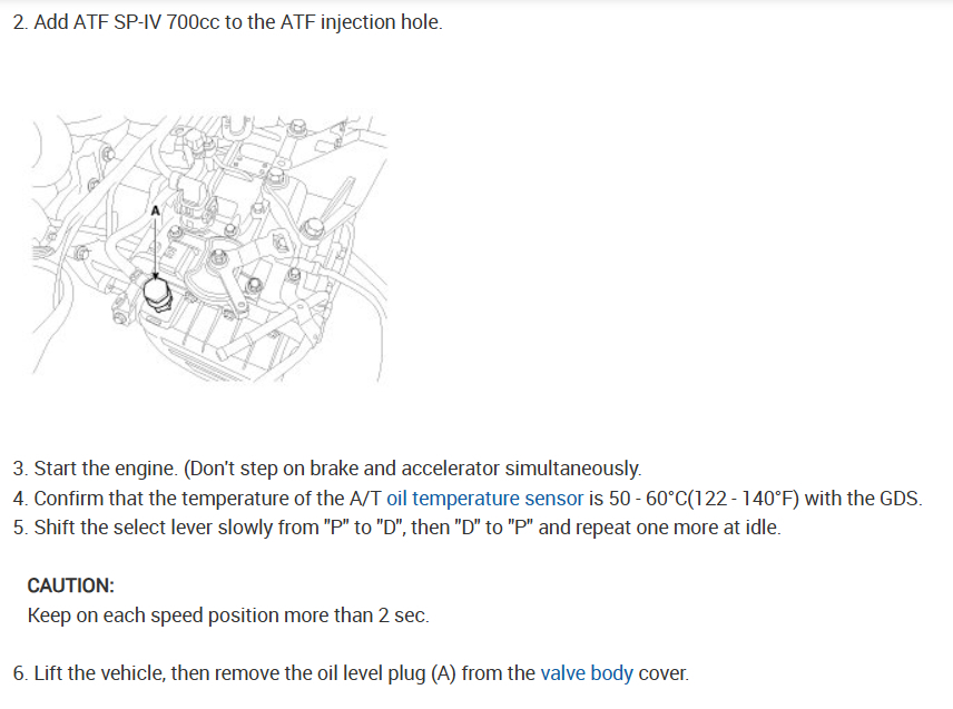

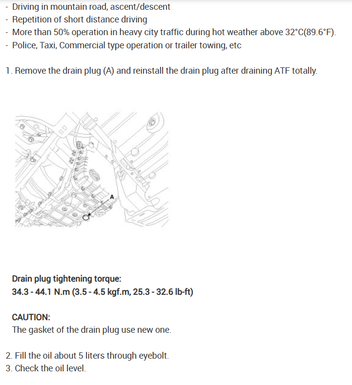

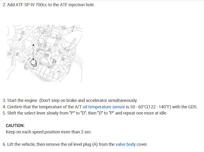

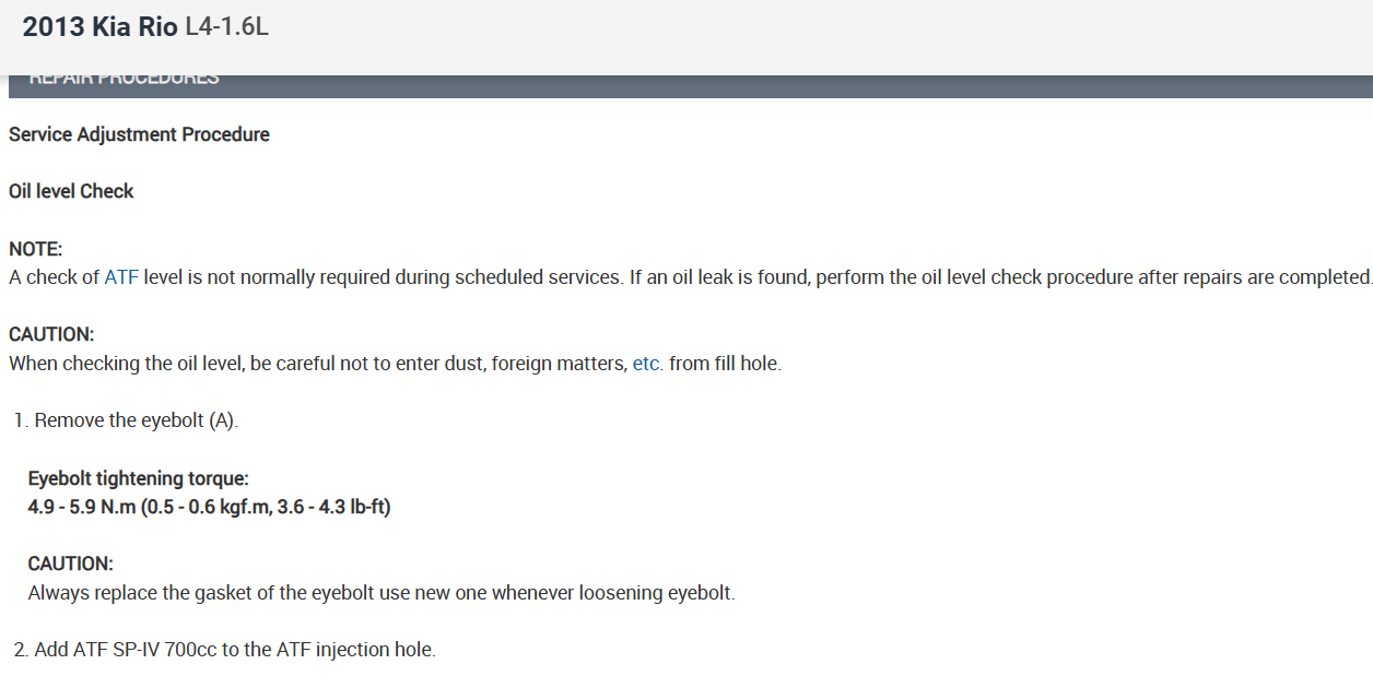

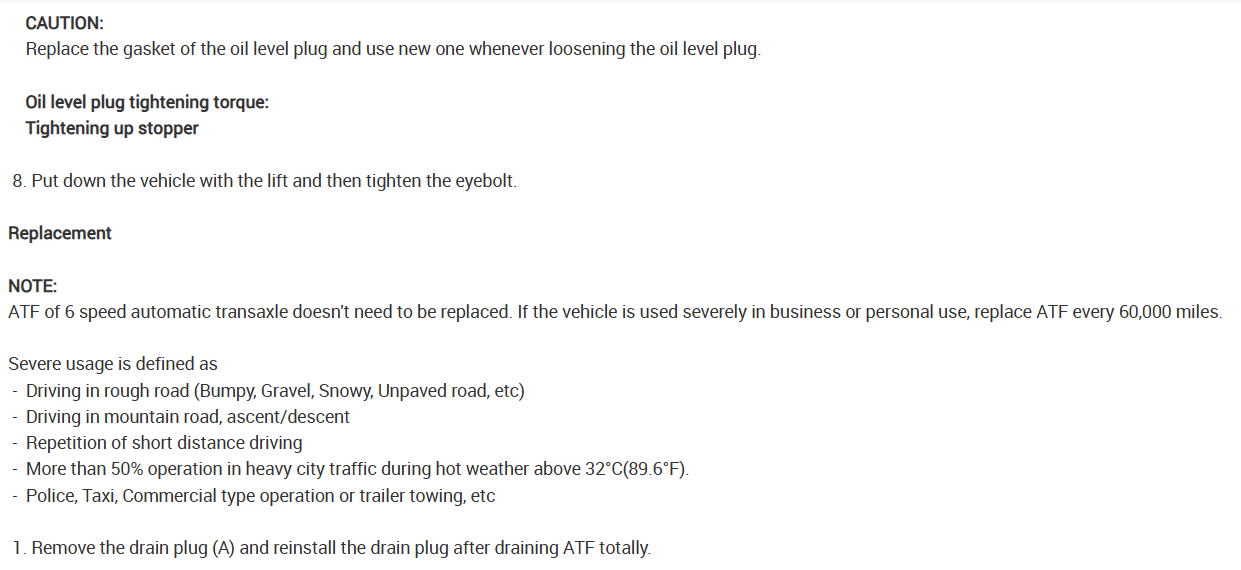

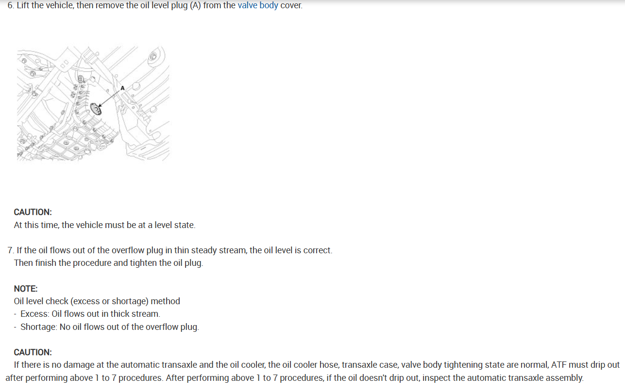

Here are the instructions for changing the transmission fluid. Check out the images (below). Let us know if you need anything else.
