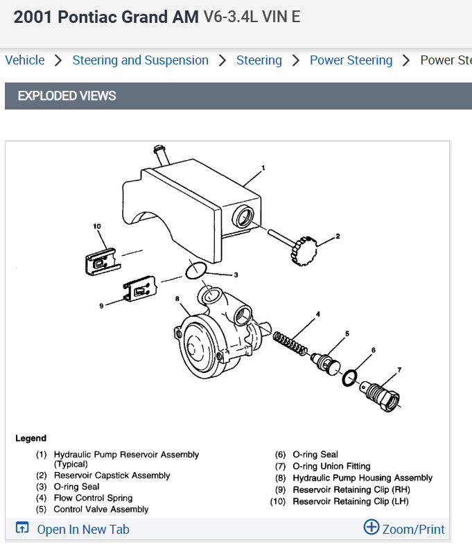

Could you tell me if a 2003 Oldsmobile Alero or a 2006 Pontiac Grand prix parts, like the power steering pump, is compatible with a 2001 Pontiac Grand Am se1 3.4l.?
Dec 2, 2024 at 8:18 AM
  • 54,832 POSTS
This depends on if the cars you have and the ones you are looking at have variable steering or not.
Without Variable Steering
P/s Pump Assembly part #26043370
With Variable Steering
P/s Pump part #26072519

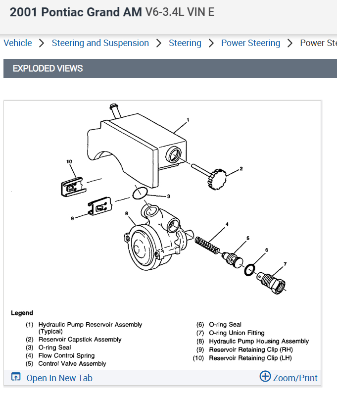

Here is what you pump looks like so you can match them up, Check out the images (below). Let us know how it goes.
