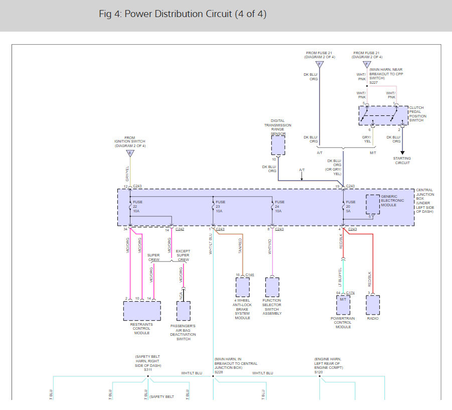

My van is equipped with compass and outside temperature thermometer mounted on the rear view mirror, but it seems like there is no power. I would like to have it fixed, but I do not know where to check, because I cannot find the fuse on fuse panel, that would power these. Any one would have a wiring diagram that would help me understand how it work?
Aug 11, 2018 at 10:37 PM
  • 55,433 POSTS
Here is the power feed for the over head console and a guide to help you see if its getting power:
Check out the diagrams (below). Please run this test and get back to us.

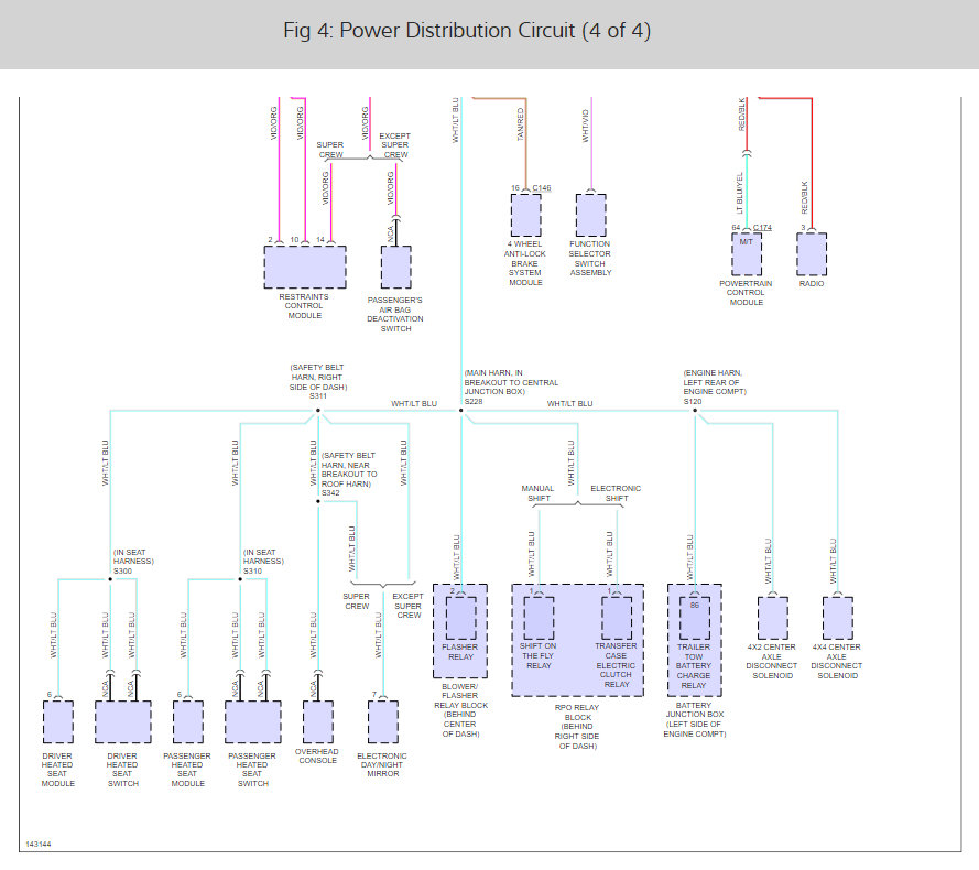

Am I blind or I cannot see anywhere on the drawing any wiring going to the compass/thermometer?
Aug 15, 2018 at 10:56 AM
  • 55,433 POSTS
It goes to the overhead console and daytime mirror, white with light blue wire should have power.
