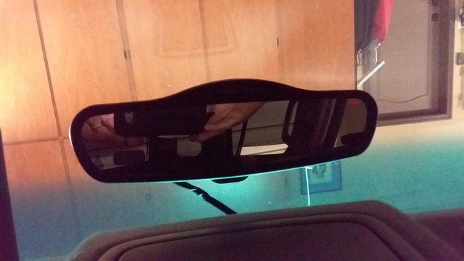

So if you now have power and ground and still no lights or compass, I have to assume the mirror is the issue. Does the compass show dashes or is it just blank? Can you get a picture of the mirror and that may help?

Mirror shows nothing, no dashes. What is concerning, the power indicator on the lower right corner of the mirror does not light up. Mirror did not suffer a really hard fall.

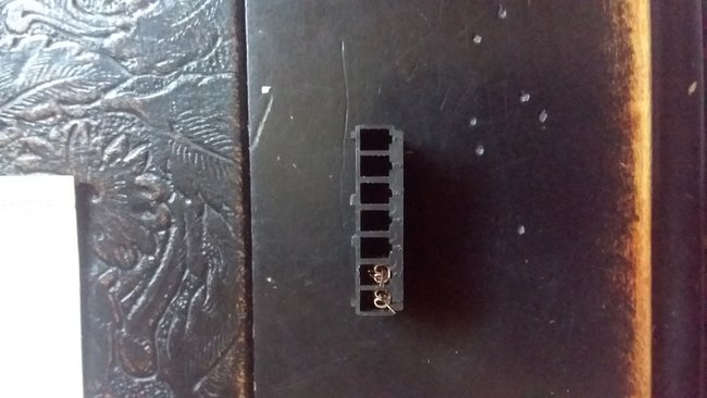

In between my troubleshooting time, I temporarily remounted the mirror so that my wife had a mirror to use while driving. It fell again, and this time the wires did break right where they go into the crimped contacts that snap into the connector, that plugs into the back of the mirror. To be sure I wire it back correctly.. The crimped contacts, are still in locations labeled "1" and "2" on the 7 pin connector that plugs into the back of the mirror. Do you know if Power is Pin "1" or "2"?
Oct 25, 2020 at 3:47 AM
Looks like the mirror power is on pin 7. Ground is on pin 6. Maybe the terminals were damaged from the last fall and now they just came completely out.

That is what I thought your image was showing also. However, if you look at the attached picture, you can see that the 2 contacts that never came out of the connector are actually on Pins 1 and 2. If I can get the contacts out, I am thinking that maybe there will still be some of the plastic sheathing on the wires, so I will be able to tell which color wire was on which pin.
Oct 27, 2020 at 2:11 AM
I think that is 6 and 7. I think you were looking at it upside down. Clearly there are only 7 pins so those are the last two pins rather then the first two. However, I think you found your issue. Those look like they are damaged and pulled out and I bet it was done when it fell the first time. Can you get a picture of the front side of the connector? If you can remove those terminals then you may be successful in repairing it.

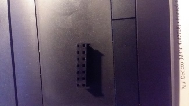

Thank you. I have reattached the picture I previously sent of the backside of the connector, and a picture of the frontside of the connector. Note: I am sorry, but I failed to point out to you that if you enlarge the picture of the backside of the connector, you will notice that each of the pin locations have a number molded into the plastic connector. The two pin locations that have the wire contacts still in them are clearly identified as "1" and "2". not "6" and "7". Again, thank you for your continued support.

sorry. picture of frontside did not send. Here it is:
Oct 27, 2020 at 11:19 PM
Sure does. I am confused though. Did this work before it feel off the first time? The reason I ask, is the mirror may not care if it is in pin 1 and 2 or 6 and 7. It may just need power and ground so the pins are not important. Clearly this would prove out if it was working prior to all this with the wires in those terminals.
