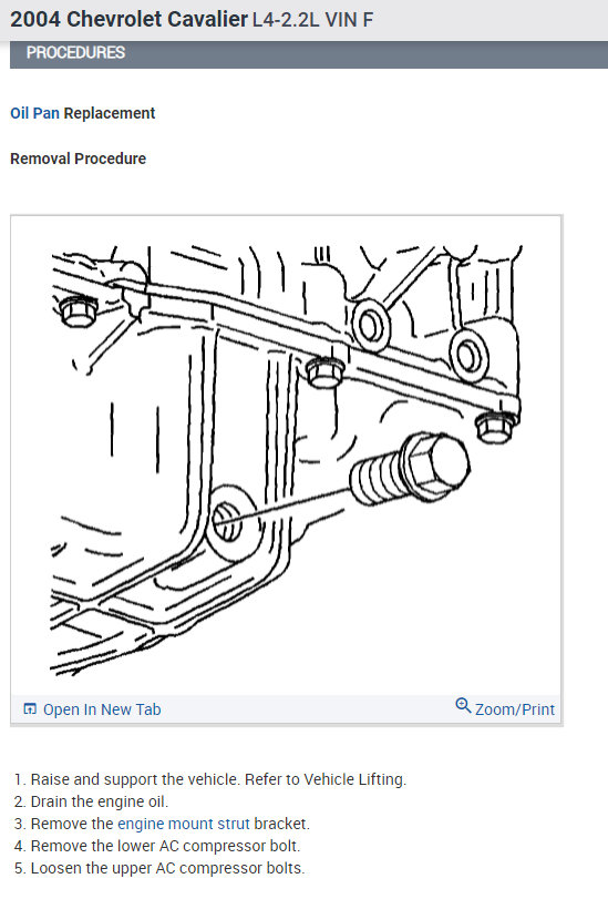

Did the oil pan from a 2005 Chevy Malibu Maxx LS set on a 2004 Chevy Cavalier base?
Saturday, August 28th, 2021 AT 4:53 AM
SQM
MECHANIC
6,383 POSTS

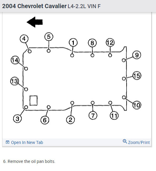

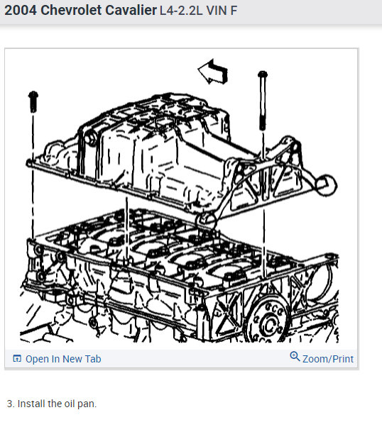

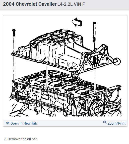

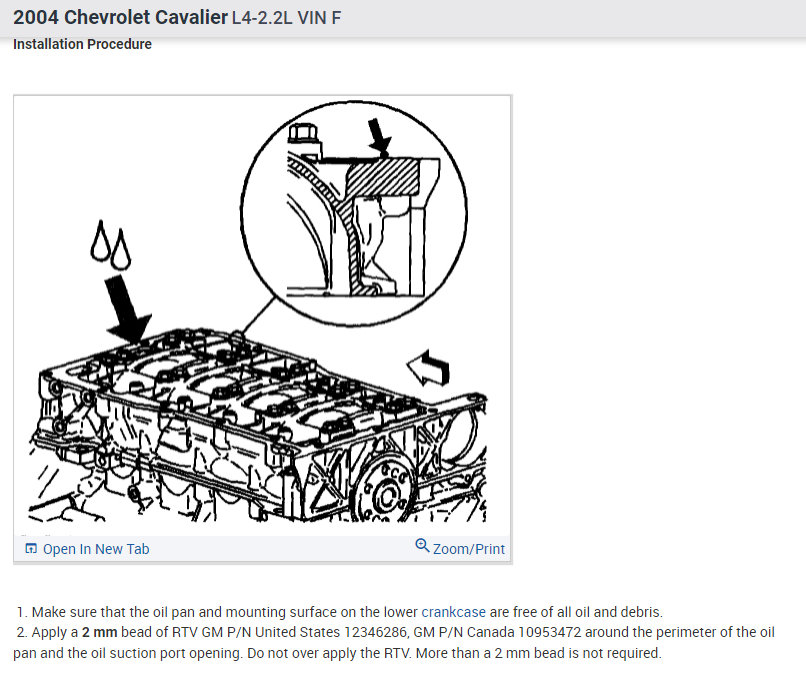

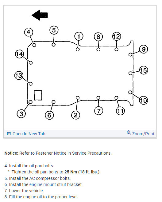

Those oil pans are not interchangeable. According to our info they are different part numbers. However the pan from a Malibu classic should fit.
I have attached the replacement procedure for your reference.
https://www.2carpros.com/articles/engine-is-leaking-oil
Let me know of any questions.
