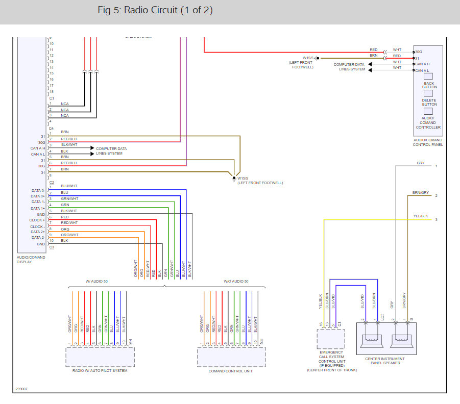

Hi there. So it is as if my radio doesn’t realize that the engine is running. Sometimes it won’t turn on at all but when I do get it to turn on it only stays on for 30 minutes and then tells me that “command will shut down unless you start your engine “ or something to that effect and then every 30 minutes it shuts off until I turn it back on. Other time it turns on and off continuously until I turn off the car. When it is doing this or not turning on at all I usually disconnect the battery (negative terminal) for half a minute or so and then reconnect it and the radio turn on. Even still it will only stay on for half hour segments though. What could this be? I have checked all related fuses and they are all fine. maybe a system update or something? I have no idea but I can’t stand driving without music!! Haha please help!!

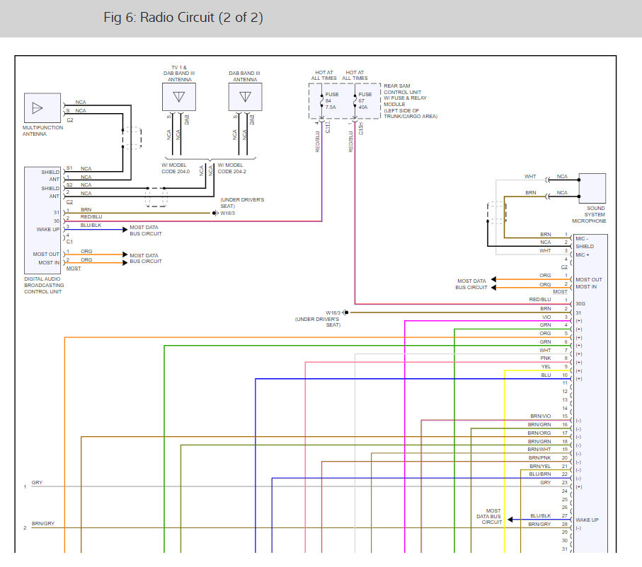

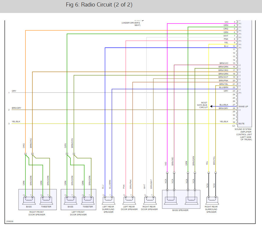

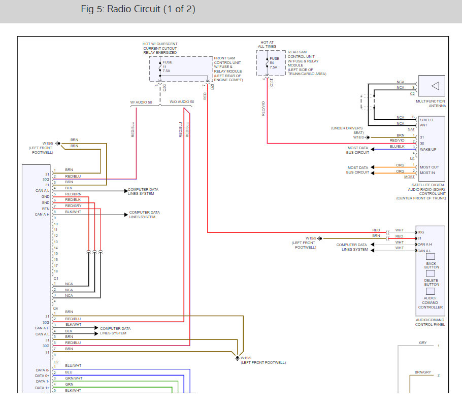

It sounds like you are having issues with the sounds command control. To be sure lets run a CAN scan to see what comes up. also I have included the radio wiring diagrams so you can see how the system works. You can get a CAN scanner from Amazon for about $40.00.
