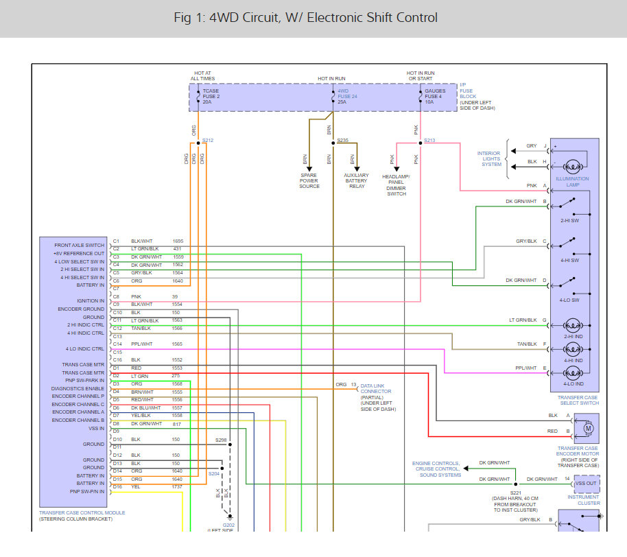

I swapped the 1999 transmission and Transfer case into a 2004 Chevrolet, and I’m trying to get my transfer case to work.

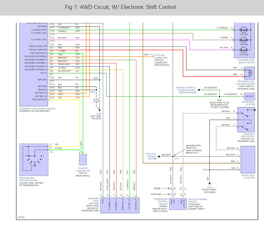

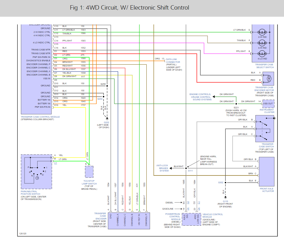

Sure, here are the transfer case wiring diagrams which can help you see what's going on and I have included a guide to help you test the connections.
Check out the images (below). Please let us know if you need anything else to get the problem fixed.
