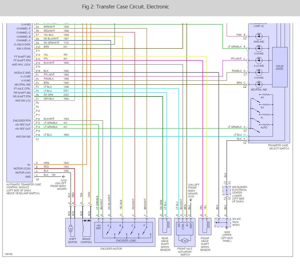

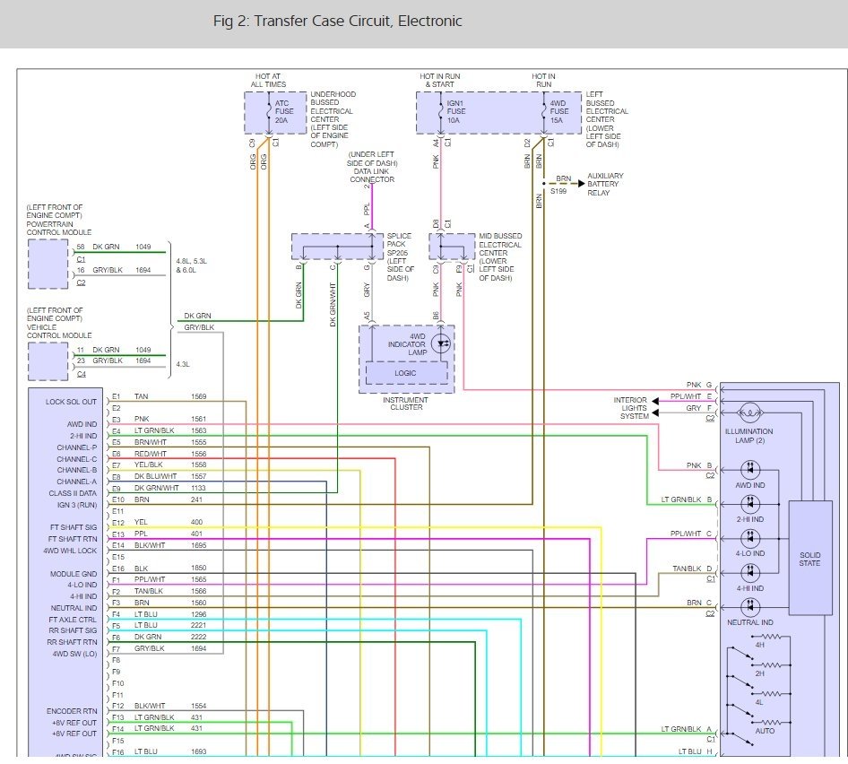

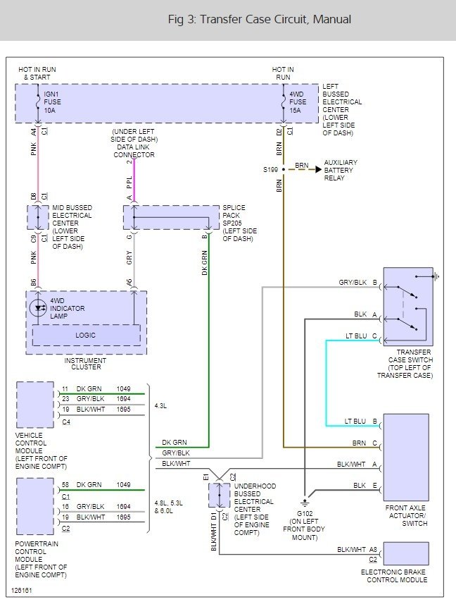

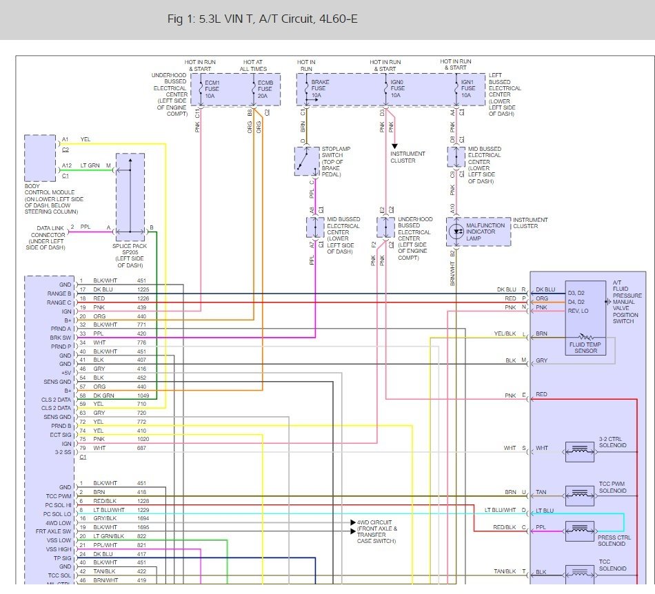

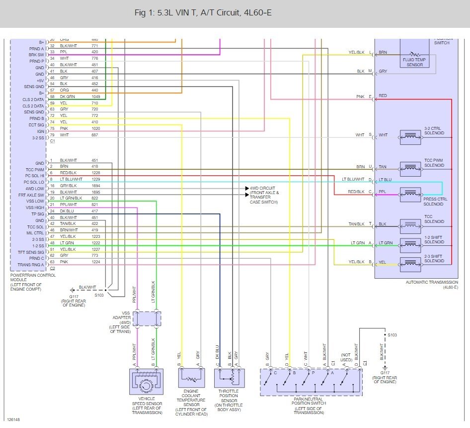

In need a color code wiring diagram for transmission and transfer case for a 1999 GMC Serria 5.3 motor 4L60e transmission what color wires go to what sensors on the outside of transmission and transfer case please in laymen terms.

I have found these guides and diagrams for you to help you get the problem fixed.
