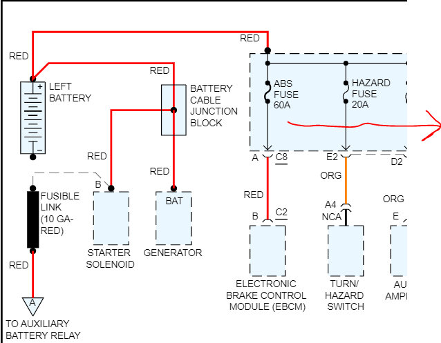

This only happens when it's really cold outside. Truck cranks fine. I let it idle to get it warmed up. It ended up shutting off after a few minutes. At that moment, the battery is too drained to crank back. Not even a click. I have to boost it for a good while. Then it will crank again, and the same thing will happen. It's only when it's cold outside. When it's not cold, there are no issues at all. I have tested the battery and alternator at AutoZone. They both check out fine. I got another battery anyway. It still does it. Any ideas? Thanks!

Great! I'll check it out. Also, I forgot to mention that the terminals are side posts but appear to be good and tight and I also have my Amp remote wire ring terminal attached and it's tight too. Never had issues. What about the other ends of the terminal wires, where are they located? I assume the hot is going to the starter and ground is going to frame somewhere? If so, where at on frame is ground located or will bad connection here even cause this issue?

I attached two pics below to help. Pic 1 is related to the positive battery terminal. And, yes, you are correct, one of the connectors goes to the starter, and another goes to the under-hood fuse box.

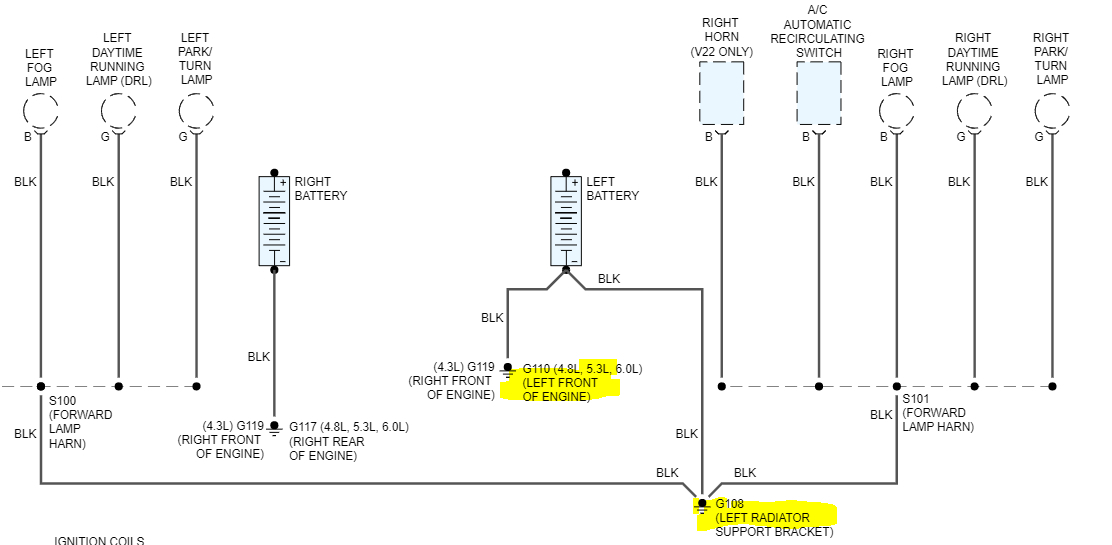

Pic 2 is the ground distribution from the battery. You have one at the left front of the engine and the other runs to the radiator support.
Let me know if this helps and what you find.
