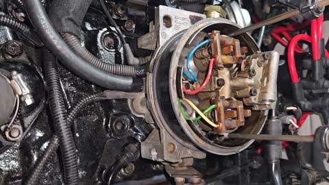

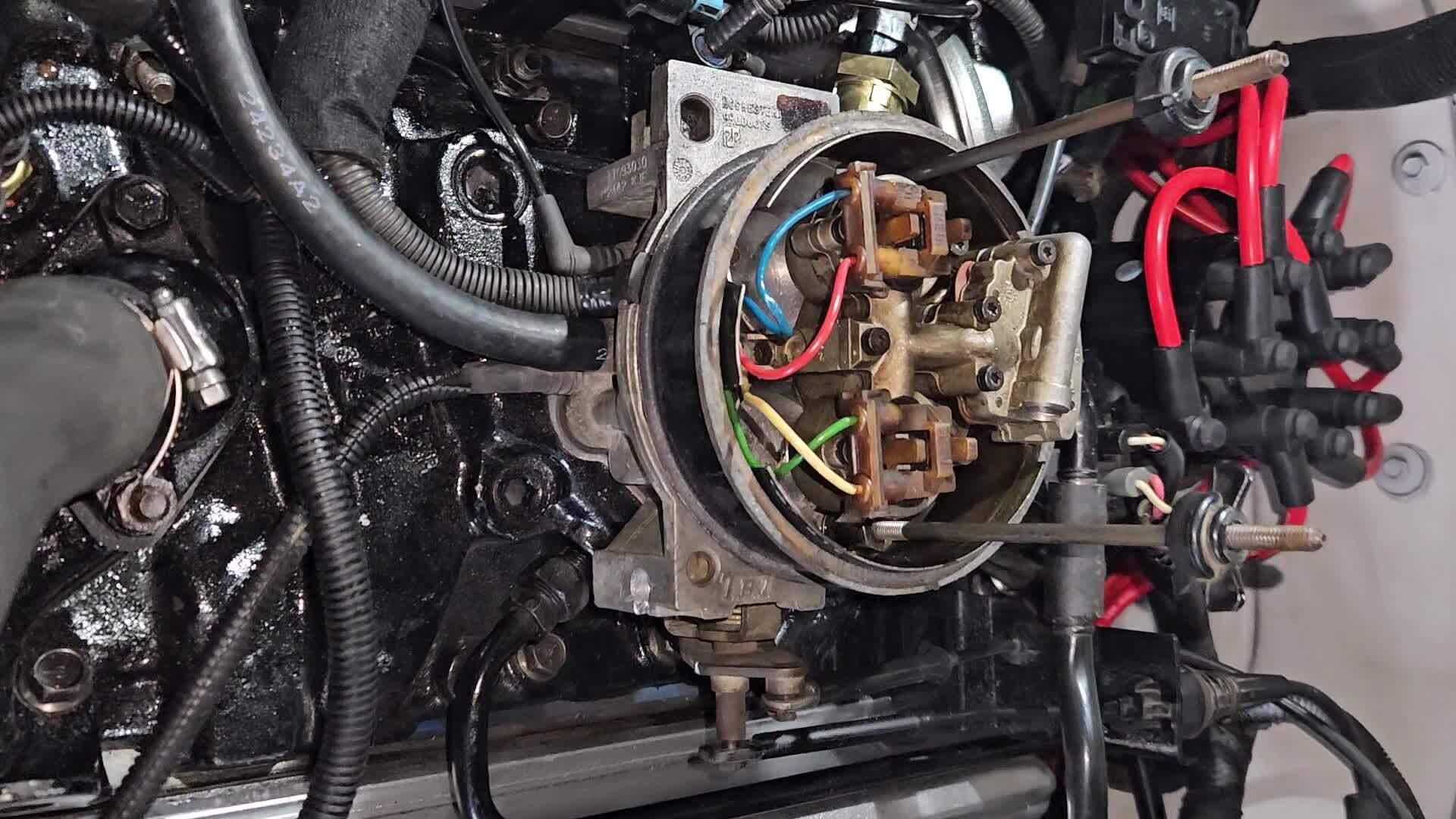

When first starting injectors make a spitting sound along with a loud vacuum sound, it does this off and on and then calms down once it warms up, then it's fine.
History: Just had the motor rebuilt, injectors new 2023, replaced the Throttle Position, Idle Control, and Temperature Sensors this week.

I have seen the gasket under the throttle body give out and cause a huge vacuum leak which sounds like what has happened or the wrong gasket is installed. I would remove the throttle body and check it out. If the gasket is okay lets run the codes to see if any are stored.

Gasket is fine and no codes are stored using jumper wire. I ordered the adapter shown.
I am installing a new map sensor today.
Is it possible the computer is failing? The reason I ask is that before the engine rebuild, I was having an issue with the EGR valve opening at the wrong time. Replaced the valve and the EGR control module and it still opens randomly at idle, I witnessed this again yesterday with this other issue, so I just plugged the EGR vacuum port. But I'm confused why it's fine after it warms up.
