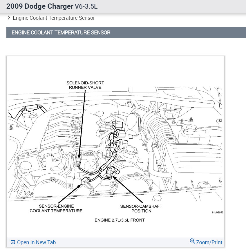

I would swap out the engine coolant sensor. The diagram below shows the location. They get weak and do not send a strong/correct reading. Check out the diagrams (below). Please let us know what you find. We are interested to see what it is.

I got the sensors tested they’re working fine, Didn’t get the o2 sensors tested but used my own basic scanner and the voltage o2 sensors showing in normal range. I’m out of option, any suggestion is welcomed of what I should test next?

To confirm there are no codes? If not I would try to service the throttle bore start by disconnecting the battery. Can I ask how you tested the engine coolant sensor?

First the guy with an Autel device tested it and then I used my basic scanner. I was told that it should be close to the ambient temperature and it was 4 degree more than ambient temperature when I tested it. Also the same guy who changed my fuel pumps also switched changed my throttle body too.

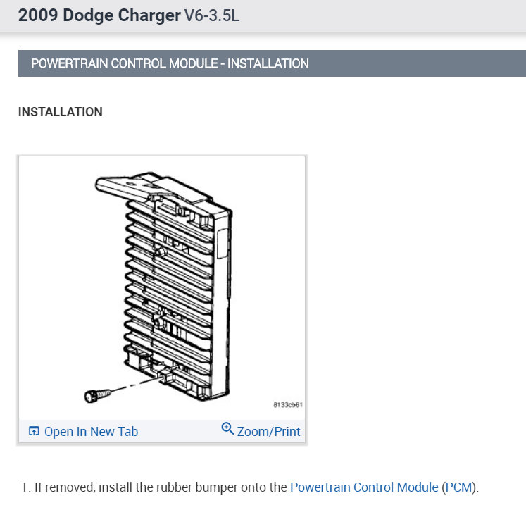

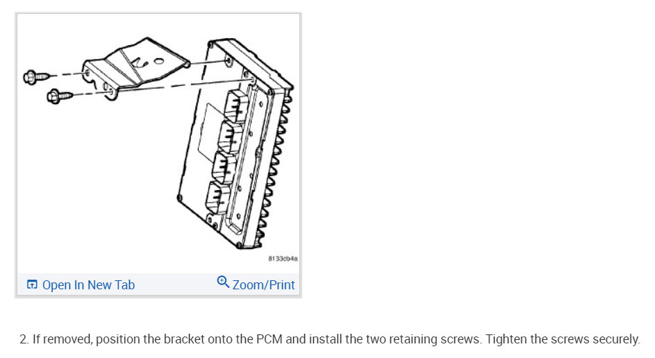

It sounds like the PCM is bad or you have a shorting throttle pedal sensor or throttle body. can you have the guy with the scanner check the readout of each while you push the throttle down? If okay I would do the coolant sensor and if that doesn't help swap out the PCM. here is are guides and instructions below. Check out the diagrams (below). Please let us know what you find. We are interested to see what it is.

I took a junk yard PCM it didn’t help problem remained same returned it and put back my original
