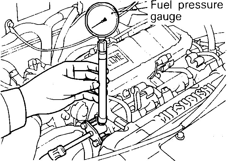

Wondering why it takes a bit to start in the cold. once the car is warm it runs fine. the only problem I have is the cold start. what could be causing this problem?

My first suspect for a cold start issue is fuel pressure or fuel pressure drop off. If the pressure drops too much, it may be taking the pump added time to rebuild the needed pressure. With that in mind, here is a link that explains how to test fuel pressure:

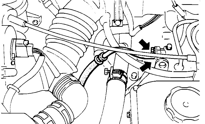

1. Turn the ignition switch OFF
Fuel Pump Power Hook-up
pic 1

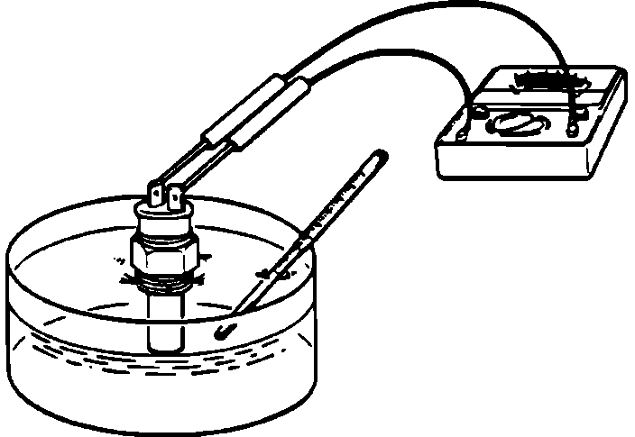

2. Apply battery voltage to the fuel pump drive connector to power the fuel pump.
Fuel Pump Operational Test
pic 2
3. Pinch the fuel hose to check that fuel pressure is felt.
NOTE: The fuel pump is mounted in the fuel tank and it operates submerged in fuel, therefore its operating sound is hard to hear without removing the fuel filler cap.

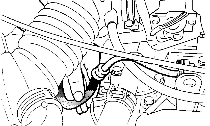

High Pressure Fuel Hose Connection
pic 3
2. Disconnect the high pressure fuel hose at the delivery end.
CAUTION: Cover the hose connector with a shop towel to prevent splashing of fuel caused by residual pressure in the fuel line.

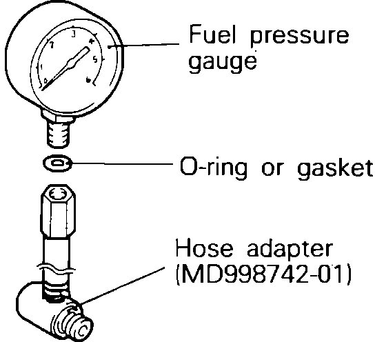

Fuel Pressure Testing Equipment And Adapter
pic 4

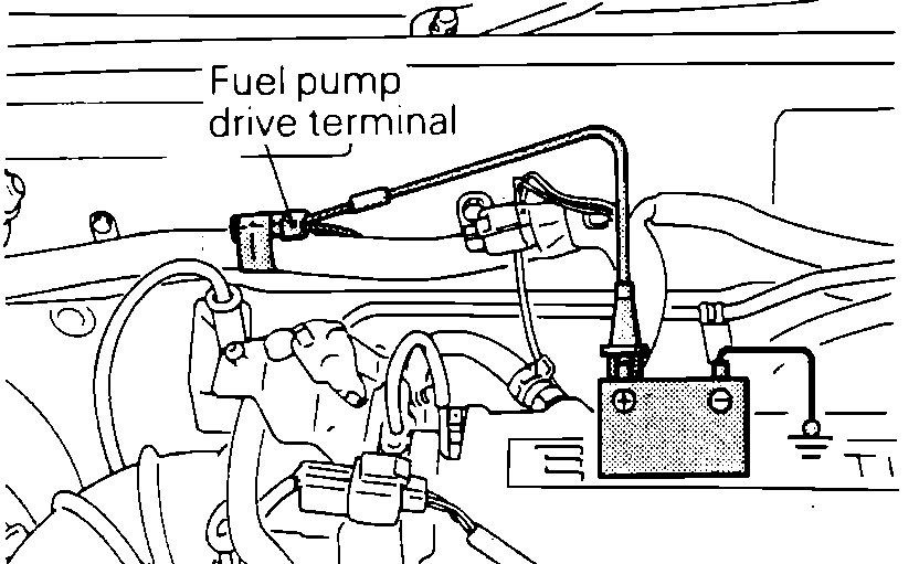

Fuel Pump Pressure Test Equipment Installed
pic 5
3. Using the fuel pressure gauge adapter (MD998742-01) or equivalent, install the fuel-pressure gauge to the delivery pipe (fuel rail).
4. Connect the battery negative terminal.
5. Apply battery power to the fuel pump drive terminal to activate the fuel pump. With fuel pressure applied check that no fuel is leaking at any of the connections.

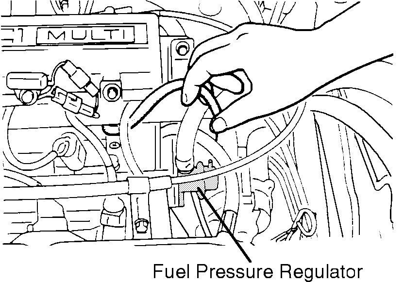

Fuel Pressure Regulator W/Vacuum Line Disconnected
pic 6
6. Disconnect the vacuum hose from the pressure regulator, and plug the hose end. Measure the fuel pressure at idle.
Standard Value: 47-50 psi (330-350 kPa)
7. Measure the fuel pressure when the vacuum hose is connected to the pressure regulator.
Standard Value: 38 psi (270 kPa).
NOTE: At the completion of steps 5 thru 7, prior to turning the ignition off, disconnect the battery power to the fuel pump drive terminal. If the engine stops and no fuel pressure is observed, there is a problem in the power supply to the fuel pump.

COOLANT TEMPERATURE SENSOR
1. Remove the engine Coolant Temperature Sensor from the intake manifold.
Checking The Coolant Temperature Sensor Resistance
Pic 7
2. Using alligator clips, connect an ohmmeter to the sensor terminals.
3. Immerse the sensing element in hot water, being careful not to set the housing in the water. This would alter the resistance reading.
4. Resistance should decrease, as the temperature increases. Refer to SPECIFICATIONS/ELECTRICAL.
If the resistance deviates from the standard value, replace the sensor.
