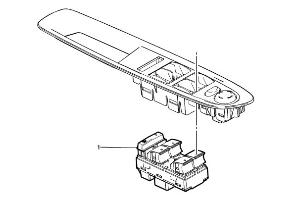

Next on the list is replacing a defective driver door window switch which now only operates driver door window. Passenger and rear windows can be made to go down but not up.

For the driver door window switch, the dealership solution is to replace the defective switch with a new one at over $760.00 Cad not covered by warranty. Can we not just take apart and clean contacts? How?

I might try to clean the swith before heading back to the dealer. How is driver door taken apart on 2012 GMC Acadia SLT?

You do not have to take the door apart. The switch pops out from the top. Do not try to take it apart though. Spring loaded parts will fly out everywhere.
