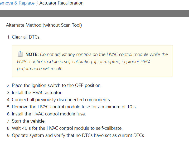

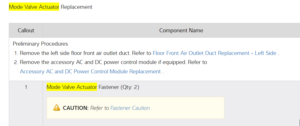

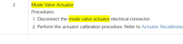

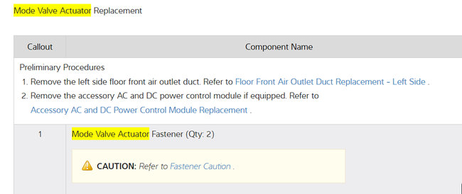

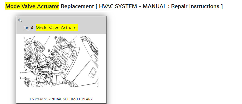

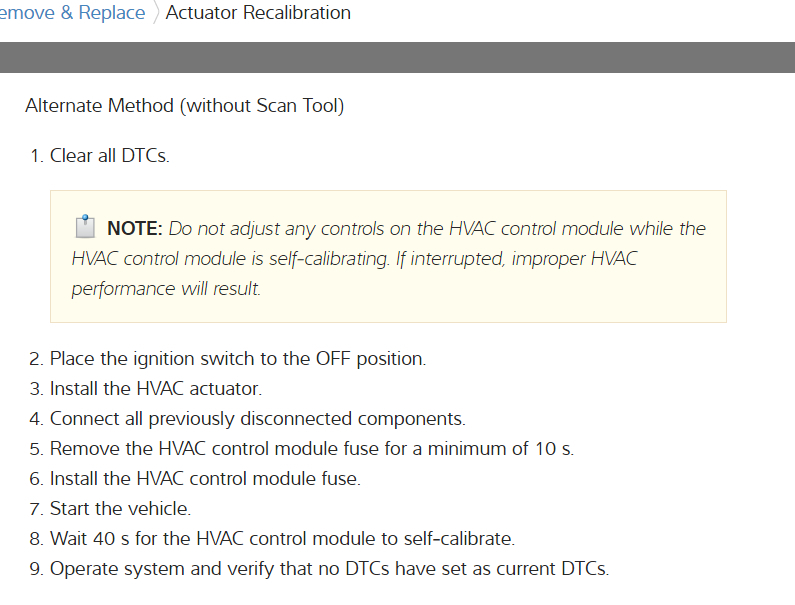

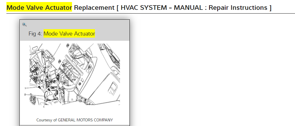

Even when I don’t want it to. It will blow out the vent I choose but it will still blow on the feet. What is going on? what can I do?

This could be a problem with your vehicle's mode actuator. This actuator is the one responsible for controlling the doors that duct the air to where it's supposed to go. In the diagrams down below I have included the factory directions for the inspection, removal, installation, and recalibrating of the mode actuator. Please go through the guides down below and get back to us with what you are able to find out.
