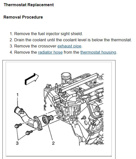

Yes, I would. Here is a guide and diagrams on how to do the job:
Check out the thermostat diagrams (below). Please let us know what happens. It shows a v6 in this car.
