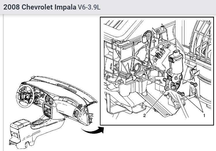

Just bought car and when I turn on the heat it blows heat out of passenger side but cold out of drivers side?
Apr 15, 2020 at 1:05 PM
DANNY L
  • 5,648 POSTS
Hello, I'm Danny.

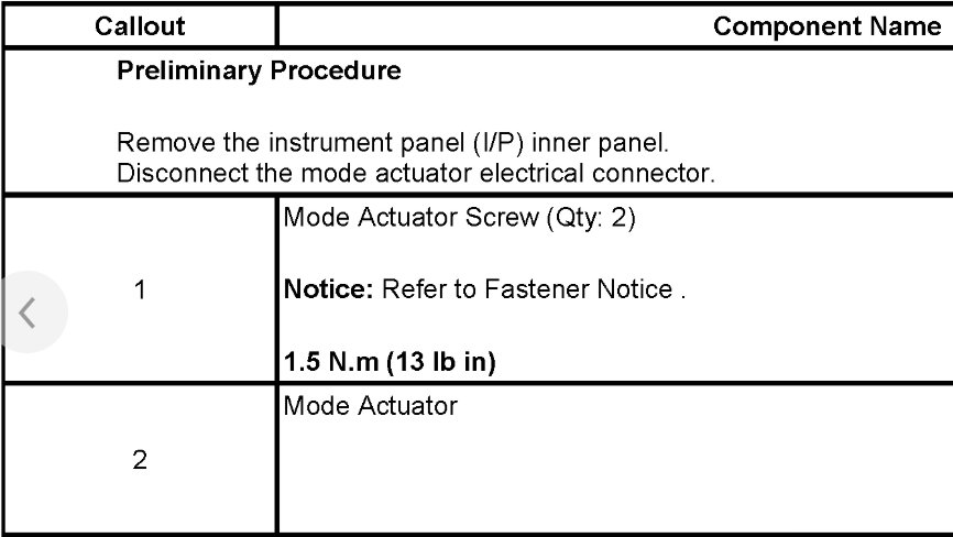

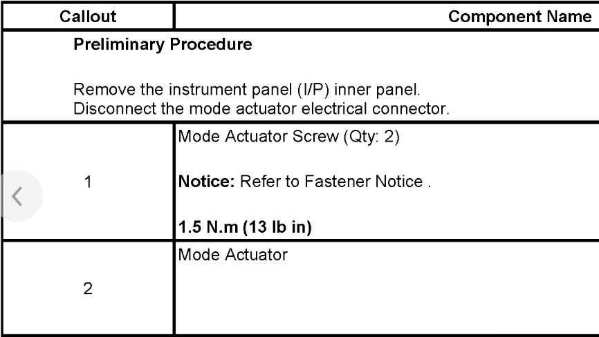

It sounds like you are having an issue with your blend door actuator.It's a small electric motor that opens/close a door to direct air flow through specific ducts.Here is a tutorial showing what is involved:
I've attached a picture below for your Impala.Hope this helps and thanks for using 2CarPros.
