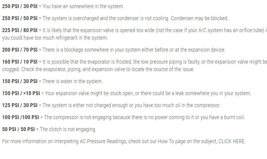

That is great info. Your pressures are pretty much equalized which is normally indicating that the compressor is not operating properly. The fact that you noticed it is staying engaged is another sign, as you noted. That is staying that way because the PCM is not seeing the pressure change so it is keeping the compressor engaged to try and achieve that. So if those pressures where with the compressor running then it is not building pressure.
Take a look at the attachment. If you had a clogged expansion valve you would have pressures like 200/70 because even though there is a restriction, your compressor would still create a pressure difference. This indicates the compressor is not building pressure. If it is coming on and engaging then the compressor is faulty.

Okay, so I did it again with the A/C on set to max cold and for the low pressure side I got around 60 and for the high pressure side I got around 150 and the outside temperature was 90 F.
Aug 9, 2020 at 8:13 AM

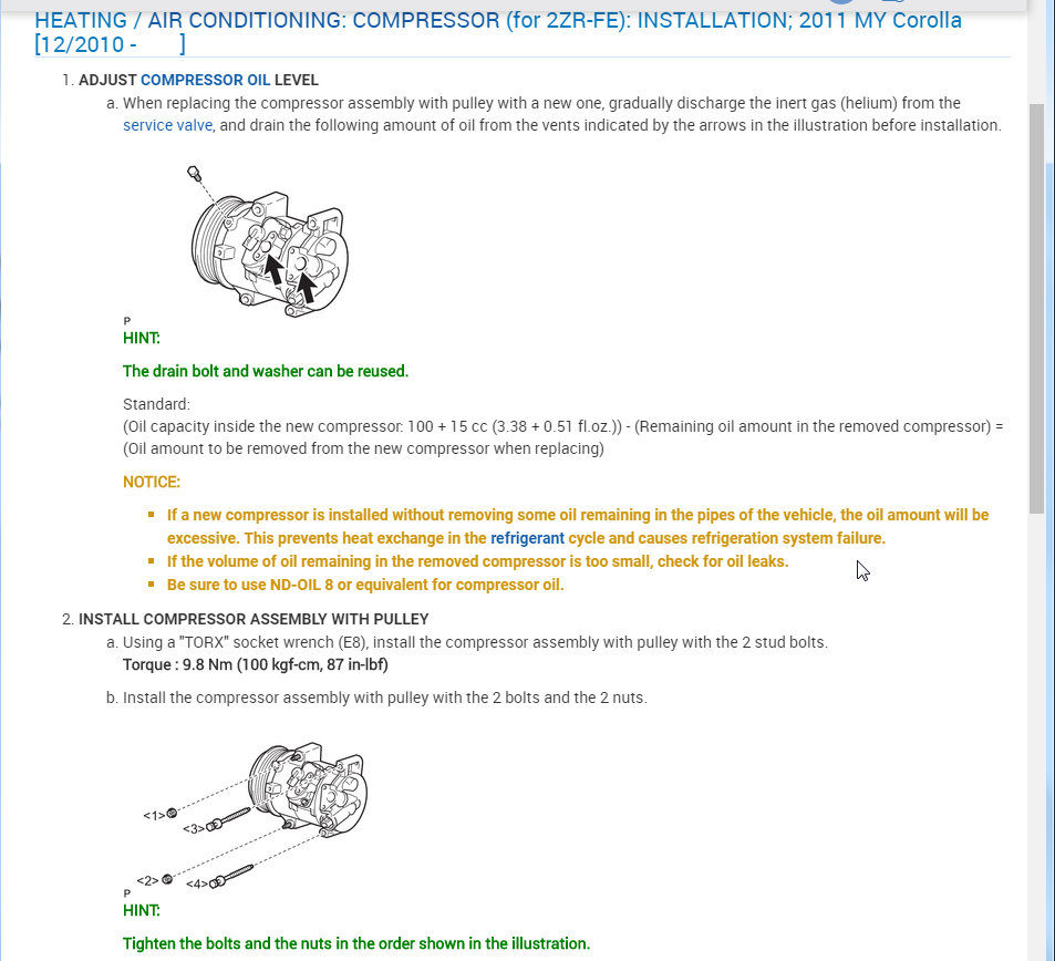

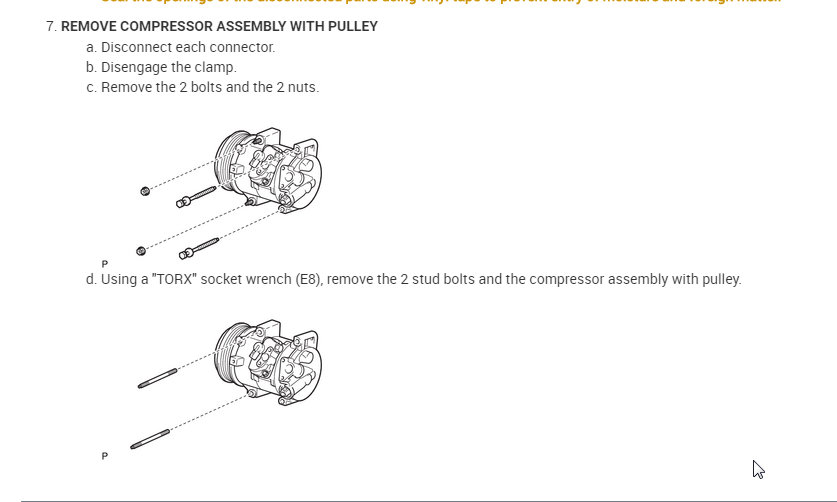

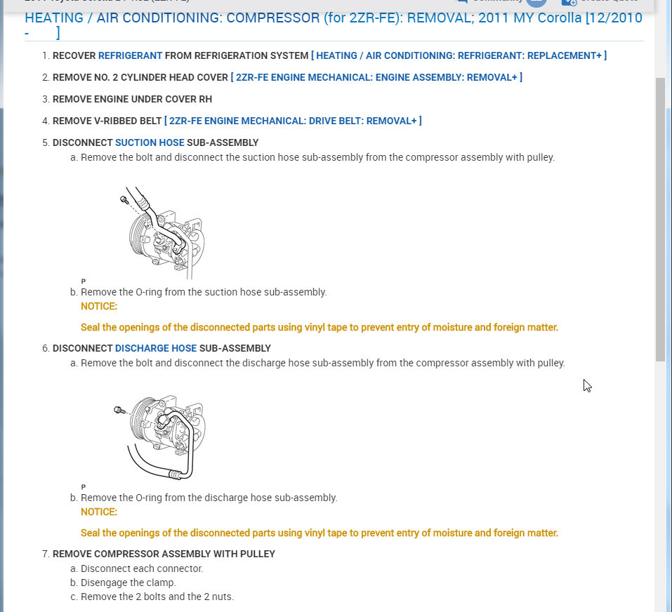

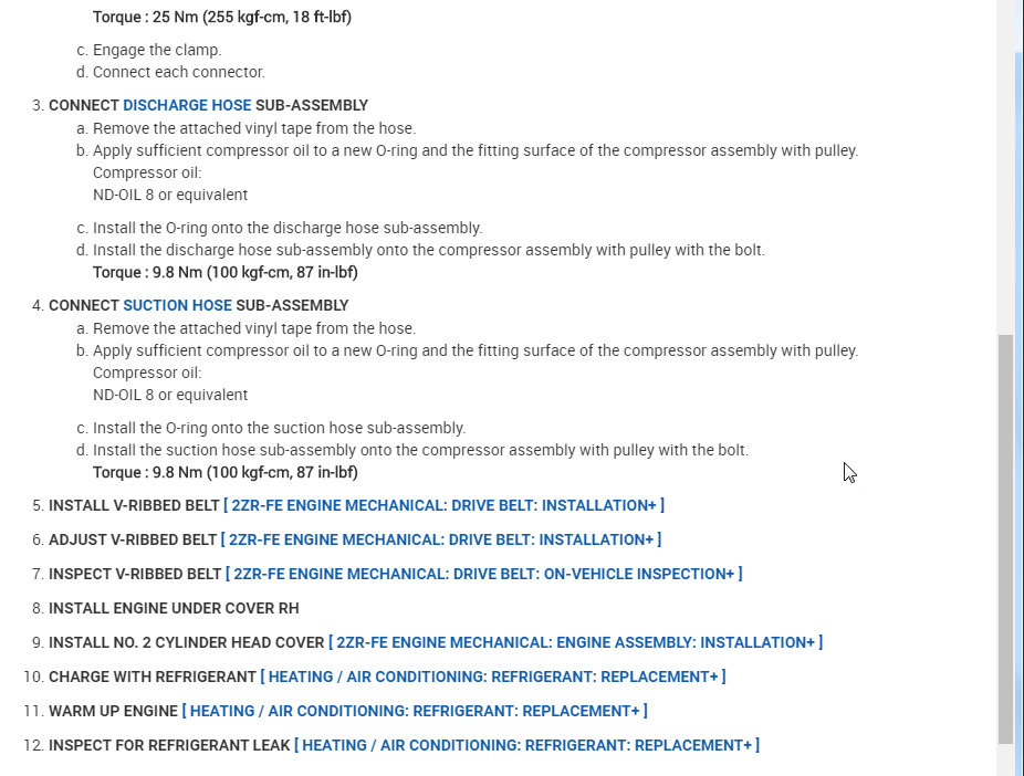

Okay. That helps but doesn't change the outcome much. Take a look at the bottom section of this attachment and you will see that your low side is slightly high and the high side is clearly low. This indicates that you need to service the system. This means evacuate the system and pull it down into a vacuum and make sure it holds for about an hour. Then recharge the system properly and retest the pressures. If you get the same results, you need a compressor.
So it looks like you need a compressor. It may be worth trying again if you are not positive the system held a vacuum for an hour. Let me know if you have questions. Thanks
