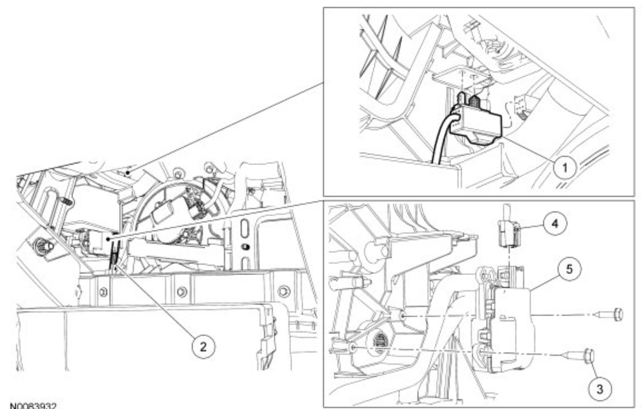

Cold air only drivers side?
89,000 MILES • 3.7L • 4WD • AUTOMATIC
DEEE
By
Sep 26, 2026 at 8:39 AM
  • 55,686 POSTS
By? Any more details? So if you are not getting cold on the passenger side, I would replace the blend door actuator of the passengers side. Here is the location.
Sep 28, 2026 at 4:57 PM
DEEE
Cold only drivers side no defrost or floor air. Both fixed YH1769 - YH1779 Motorcraft thanks for the diagram
