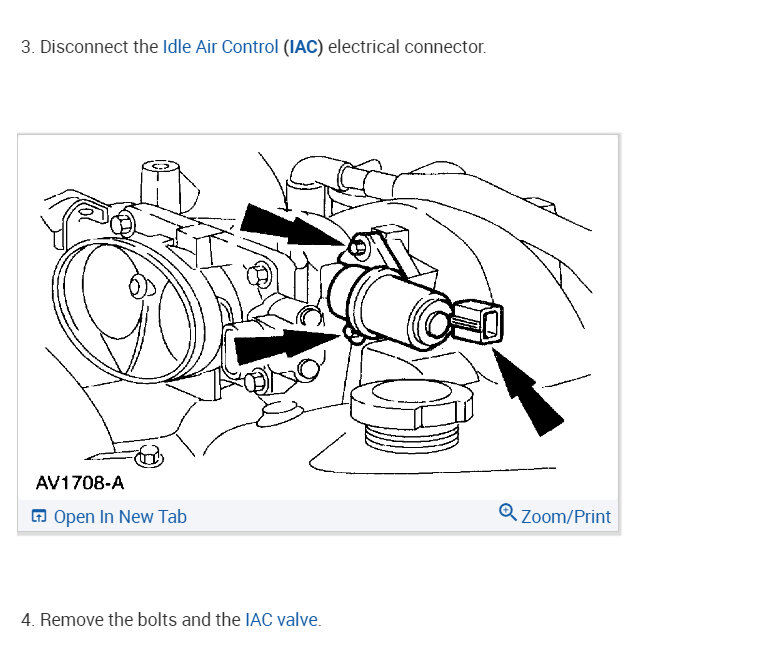

While sitting at idle the cold air intake tube will start to make a noise, like blowing into a bottle, and pretty loud. If I give it gas it'll stop. I put my hand on the intake tube where the intake manifold temperature sensor is, and it vibrated pretty good when the (sucking?) noise started. I've changed the mass air flow sensor and the air filter. All the connections are tight but it's making this noise. I'm trying to get a video, but it doesn't always happen.

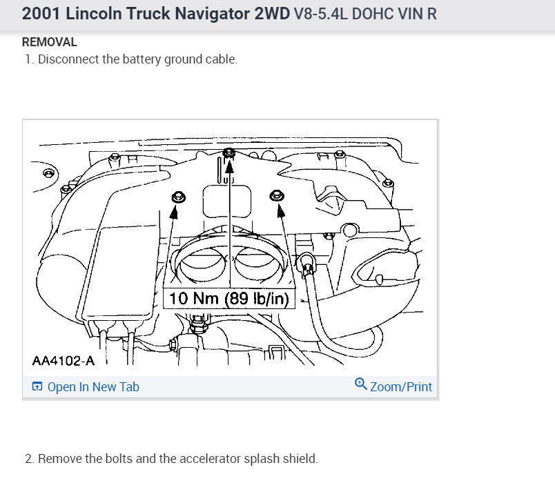

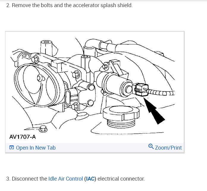

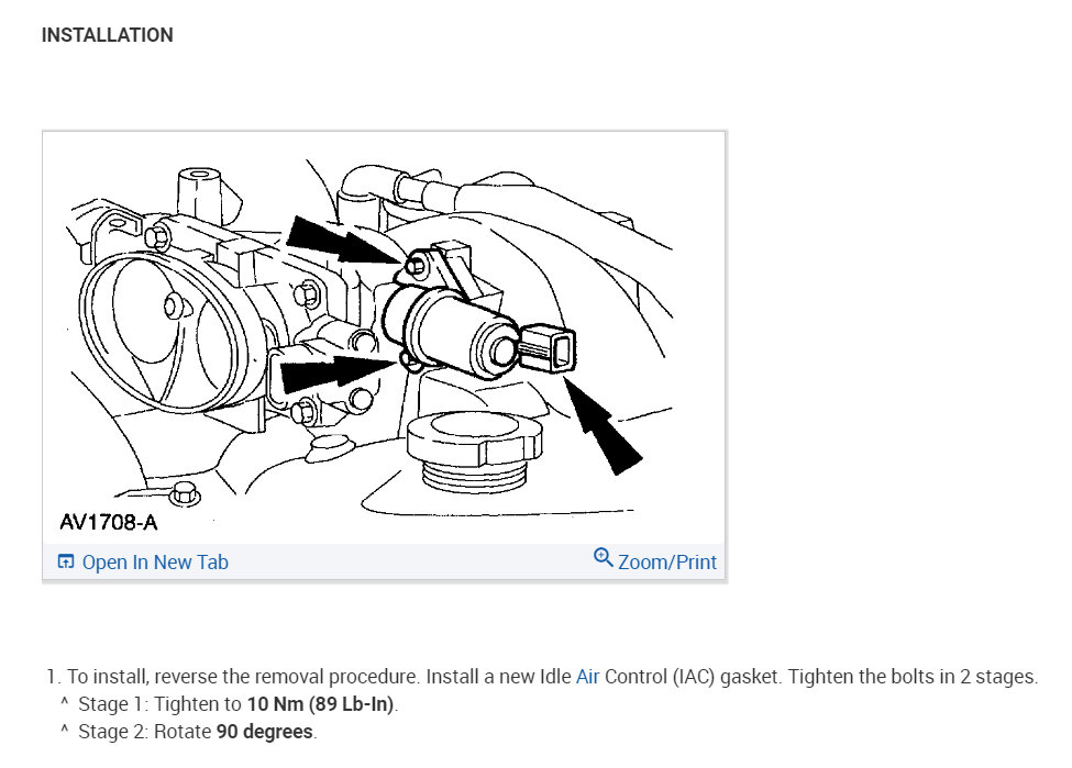

Yep, this honking noise is caused by the IAC motor that needs to be replaced. To be sure, can you please shoot a quick video with your phone so I can hear the noise? That way I can tell for sure what's going on. You can upload it here with your response. Here is the location of the IAC in case you need it. Check out the images (below). Please let us know what happens.

I changed the IAC Motor then reset the check engine now all kinds of bells and whistles are going off. What am I doing wrong? I'll be honest, I don't know how much more of this I can take but a match in the gas tank is looking more and more appealing.
