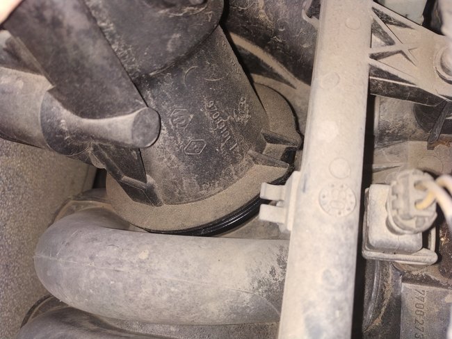

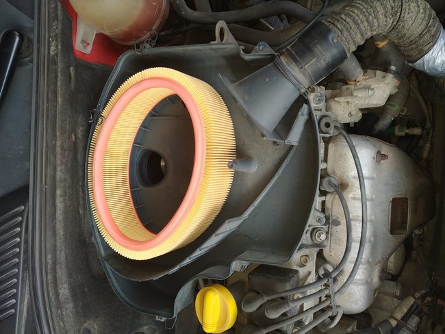

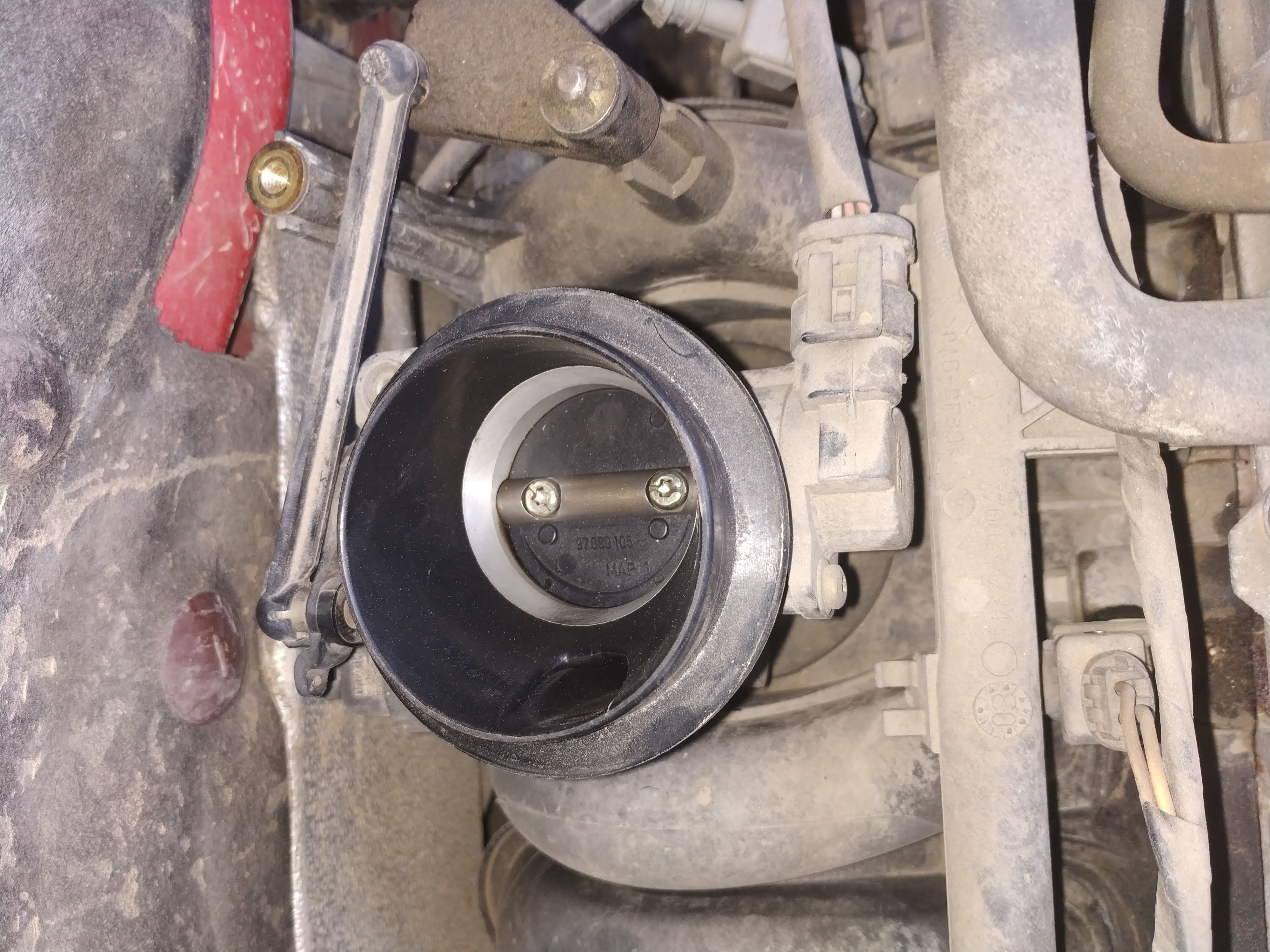

Hi, I want to install cold air intake on my car but the air box is holding throttle body in place. so when I remove air box throttle body is free to move as you can see on picture. so how can I install aftermarket intake?

Can you reload the picture for me? I don't see it here.

Here you go:

Yeah, but the problem is still the same that throttle body is not mounted to intake by screws or any clamps, but the big OEM air box is holding it down. so when I remove it and add cold air intake and press the gas it will pop out.

That is a tough one. You probably will have to fabricate something that will clamp around the throttle body and the cold air that will hold the two in place. There really is no right answer here, all I can say is you will have to be creative. Sorry, I know that's not what you want to here, but in this case there just isn't a silver bullet I can offer you.
