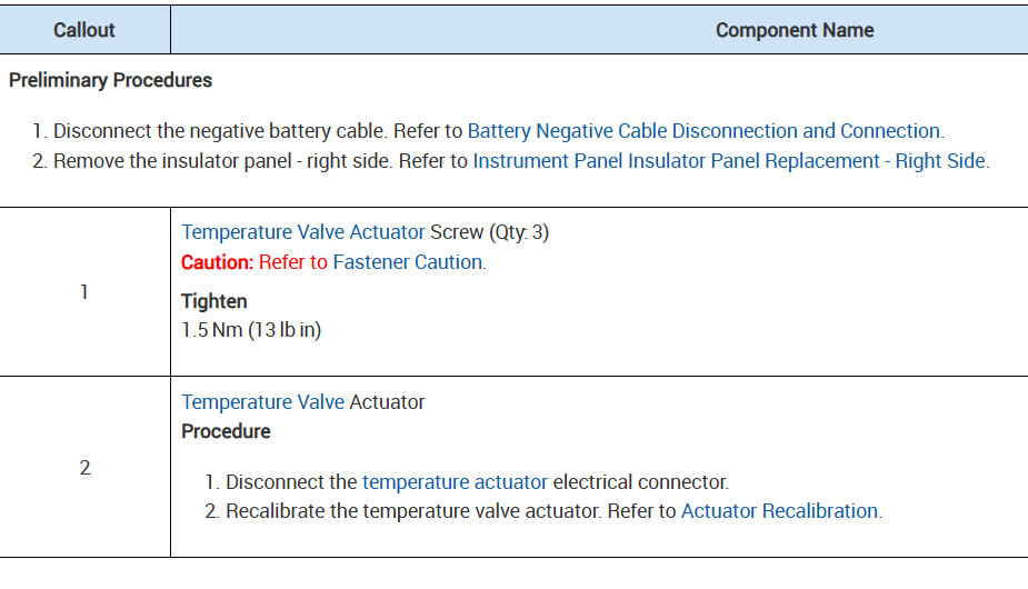

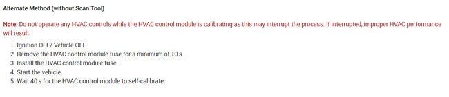

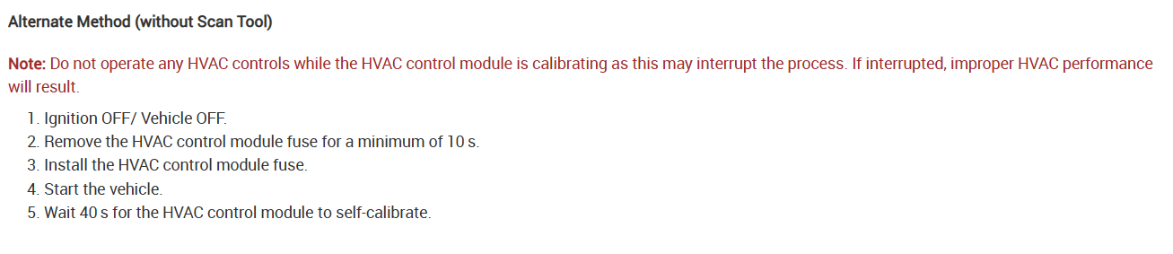

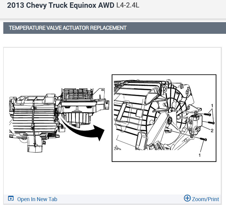

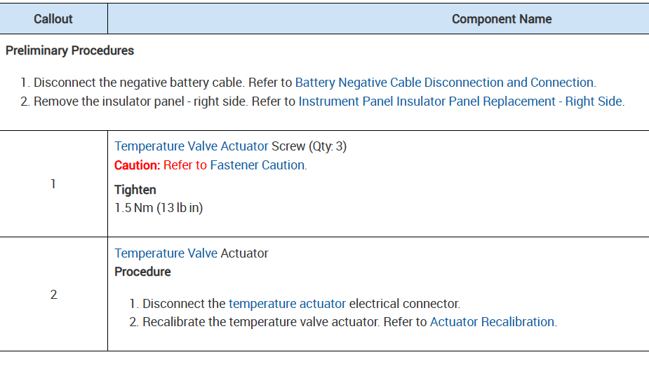

Yep, it sounds like the temperature blend door actuator is no good, here is the location of the part that needs to be replaced but I would check the engine coolant level first. Also, here is a video for you to go over as well:
https://www.youtube.com/watch?v=SNRb6pSwYuU&t
Here is the location of the blend door actuator and how to change it out, you will need to decide if it is a job you want to tackle. I also included how to recalibrate the actuator once installed. Check out the images (below). Please upload pictures or videos in your response of any problems so we can see what to help you with.

  • 55,423 POSTS
Can you upload images of what you are seeing? The above diagram is all they give us, but if I can see what you are talking about it will help.
