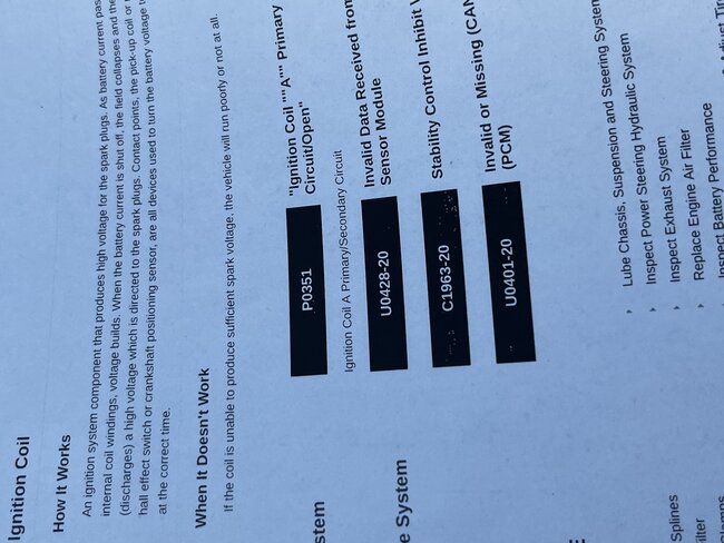

My truck keeps throwing the P0351 code even after changing the coil multiple times. It’s the only code the truck is showing. After clearing the code runs great for about 30 miles then starts missing vibrating and the P0351 comes back on? Please, this is getting expensive to keep throwing coils at it, it also has new OEM plugs.

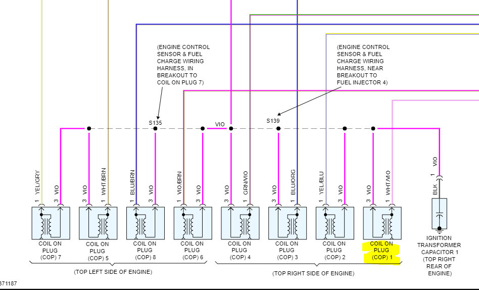

The code is certainly coil related, but it doesn't indicate a bad coil. When this DTC is set, the PCM enters failure mode effects management (FMEM) which shuts down the injector for the associated cylinder in order to protect the catalytic converter.
The cause can be a few things. However, most commonly, we have a wiring issue. Here is what I need you to do first:
Use the 12-volt non-powered test lamp to verify the Start/Run key positions voltage at the ignition coil harness connector.
Disconnect the cylinder 1 coil pack. There should be two wires present, one is violet and the other is white with a violet tracer.
With the key in the run position (engine off), the violet wire should have power at all times. Confirm that for me.
If that is good, place the alligator clip of the test lamp on the positive battery terminal and probe the white wire with the violet tracer. Have a person crank the engine. The test lamp should strobe on and off.
Do this and let me know the results.
See pic below.

My truck has power to the violet wire when tested the white with violet no strobe and truck started like normal with the coil off now what? Thank you

I have no power to the white with violet wire going to the number 1 coil, any suggestions?
Mar 25, 2023 at 6:26 PM
  • 110,194 POSTS
the white/violet goes to the PCM. The PCM provides a ground path that completes the circuit. If you had the alligator clip of the test lamp connected to the positive side of the battery and the other end to the white/violet wire, it should strobe (while cranking) when the PCM completes the circuit.
Is there any evidence of wire damage? Let me know. We may need to check at the PCM itself for the ground path.
Mar 25, 2023 at 9:26 PM
SHERI ALLEN
  • 36 POSTS
No the wires look okay, but there is no strobe effect on that wire.
Mar 26, 2023 at 12:28 PM

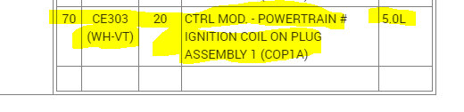

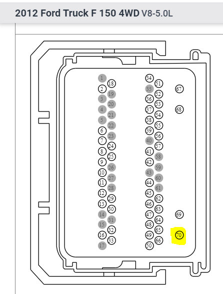

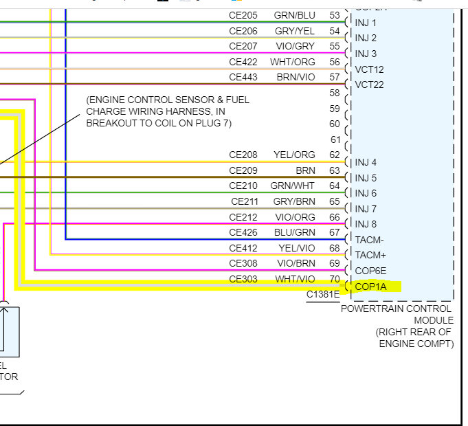

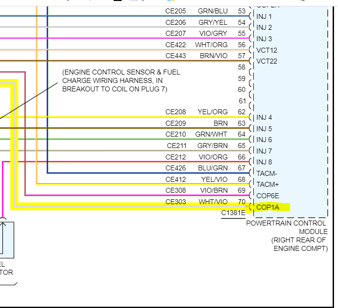

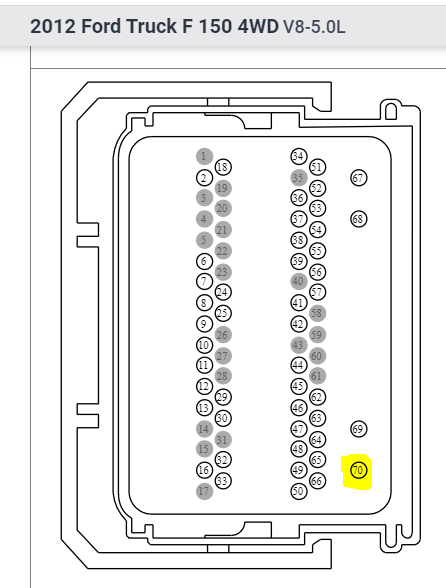

  • 110,194 POSTS
Okay, we need to go to the PCM to see if the ground path is present there. It could be something as simple as a broken wire or pin at the connector, or the PCM may have failed.
Pic 1 shows the white/violet wire at the PCM. Pic 2 confirms it is pin 70 in the black PCM connector. Pic 3 shows the pin location. I need you to disconnect the connector and inspect it for corrosion or damage on pin 70.
If that is good, then we need to probe that connector and see if the test lamp strobes at the PCM. If it doesn't, the PCM is my primary suspect.
Note: I always recommend the battery gets disconnected anytime the PCM is being disconnected or reconnected.
Let me know what you find.
Mar 26, 2023 at 8:26 PM
SHERI ALLEN
  • 36 POSTS
Okay, we have strove on white with violet wire truck is still throwing PO351 code and missing vibrating when code is thrown, I’m at a loss with this truck.
