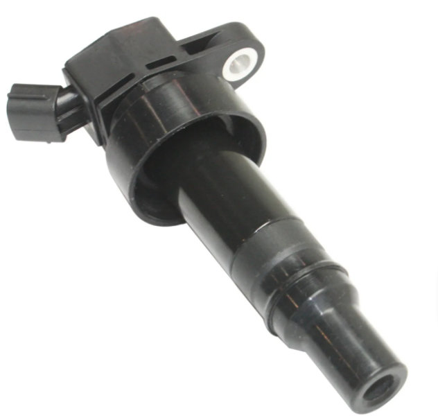

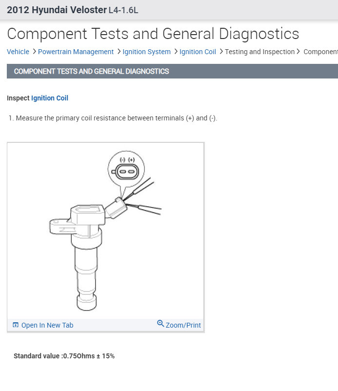

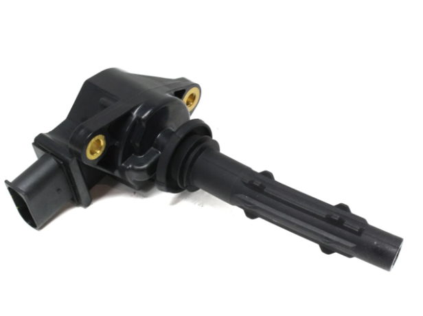

I have added the picture of the coil for both of the 2012 Veloster (first picture), and a 2007 C230 (second picture).
As you can see that they are physically different. Also, the Veloster uses a 2-wire connector and the C230 uses four wire connector.
Also, they have different internal specification, like spark output, resistance.
This is why they are not interchangeable.
Hope this helps.
