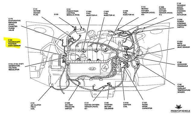

My engine turns over but coil will not fire.

The most common cause of no ignition spark is a faulty crankshaft position sensor. I'm not certain what vehicle you have, so I can't provide the specifics for you. However, take a look through these links. They explain how a crankshaft position sensor works and common symptoms.
https://www.2carpros.com/articles/how-a-crank-shaft-angle-sensor-works
If you determine the sensor is bad, here is a link that explains in general how one is replaced:
I attached a pic below showing the location of the sensor on a Ford Taurus 3.0L as a reference for you.
