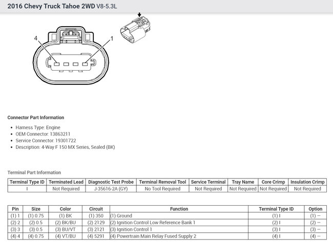

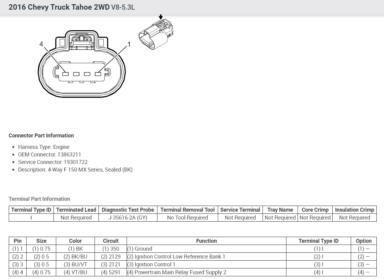

coil wiring diagrams? Can I get the coil connector pin out diagram for electrical wiring harness?

Sure, but each one is different what cylinder do you need, here is the #1 cylinder to see what you will be getting. Check out the images (below). Please let us know.
