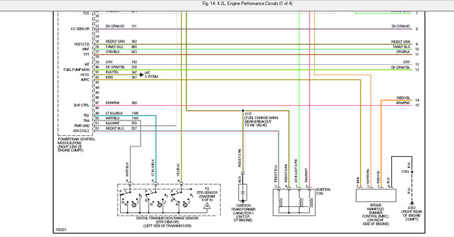

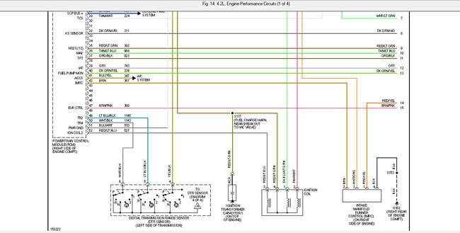

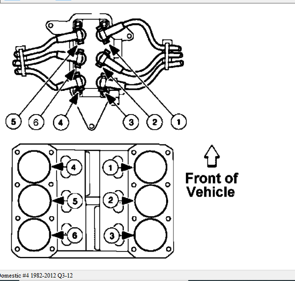

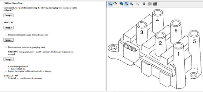

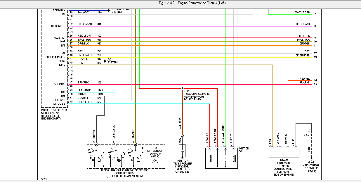

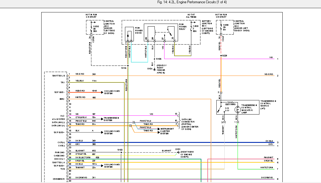

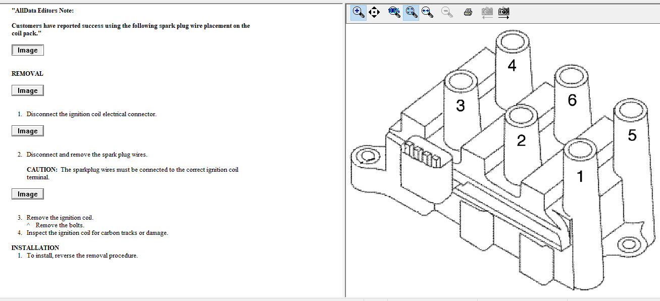

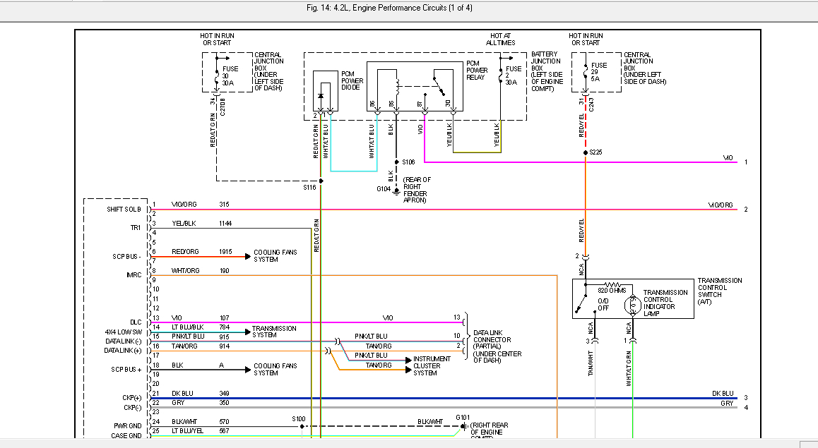

Someone removed coil, need diagram to complete job.
Wednesday, February 3rd, 2021 AT 10:03 AM
2 Replies
SEVAG P
MECHANIC
405 POSTS

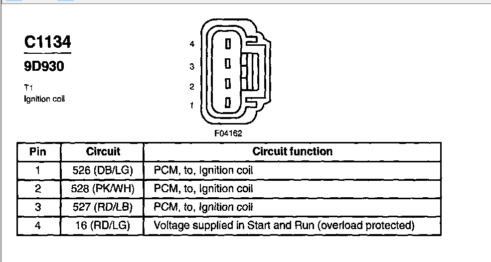

i am sending you ignition coil connector wiring diagram which are attached below.
Check the diagrams below ignition timing for coil to spark plug cables.
Let us know if you need more help.

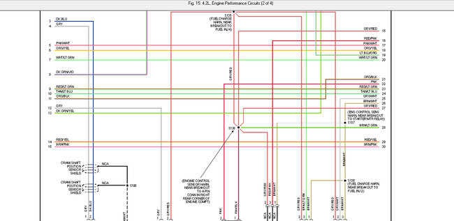

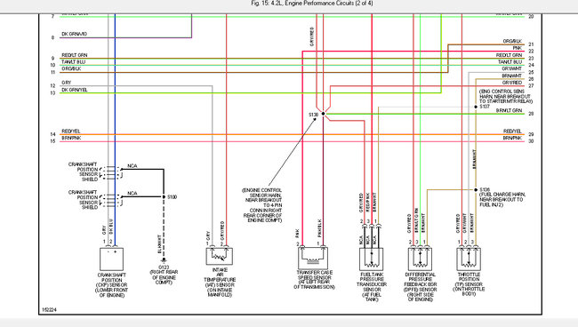

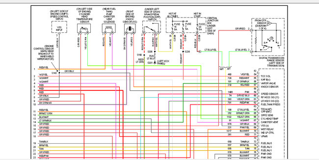

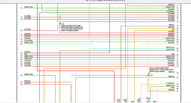

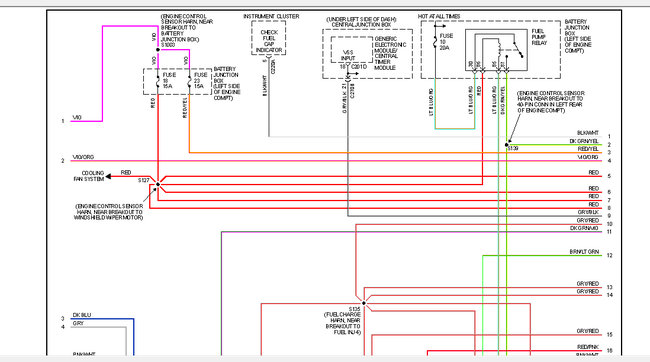

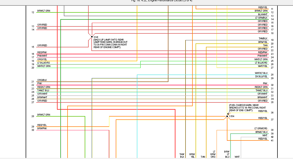

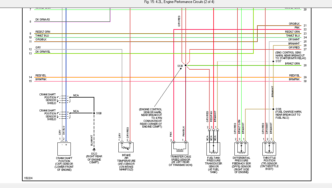

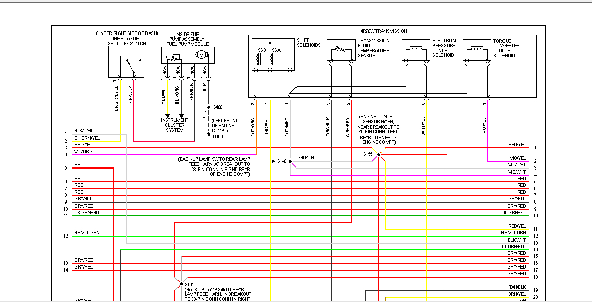

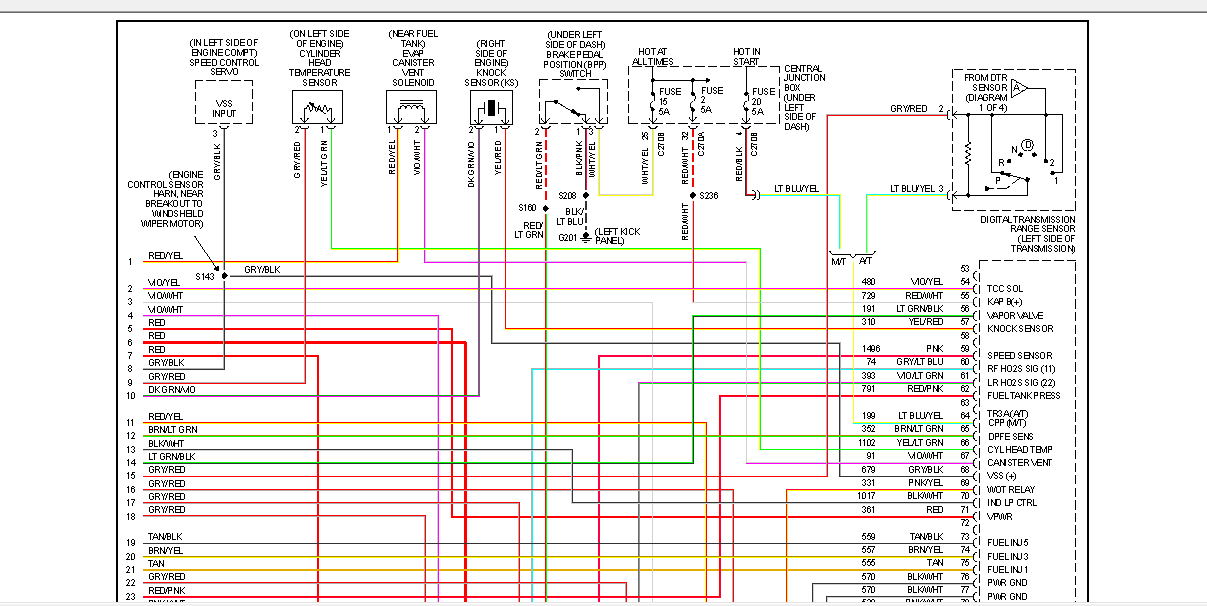

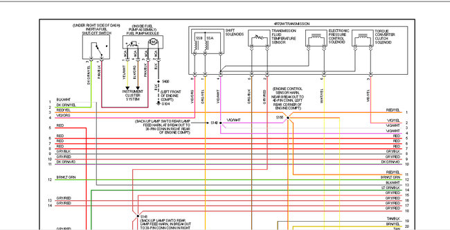

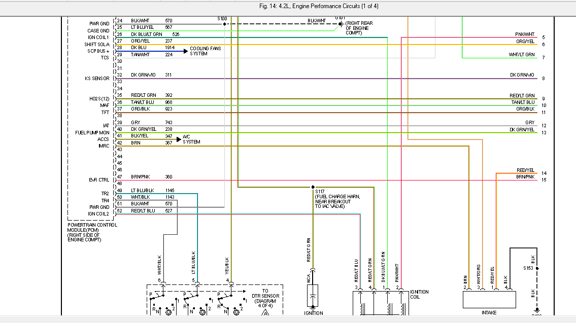

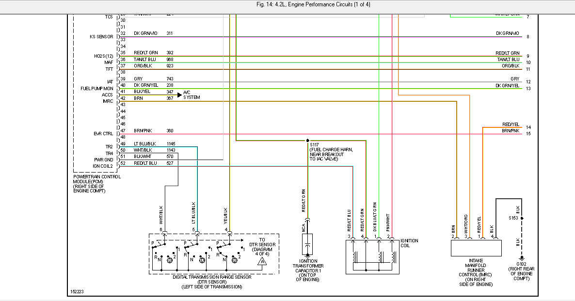

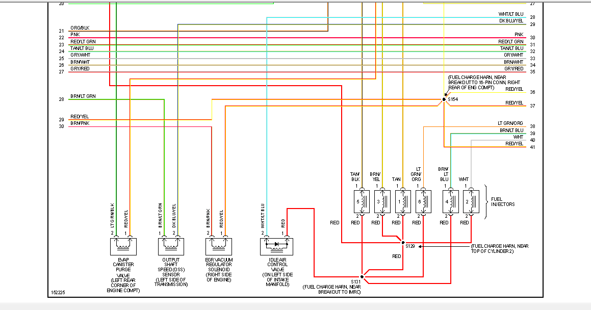

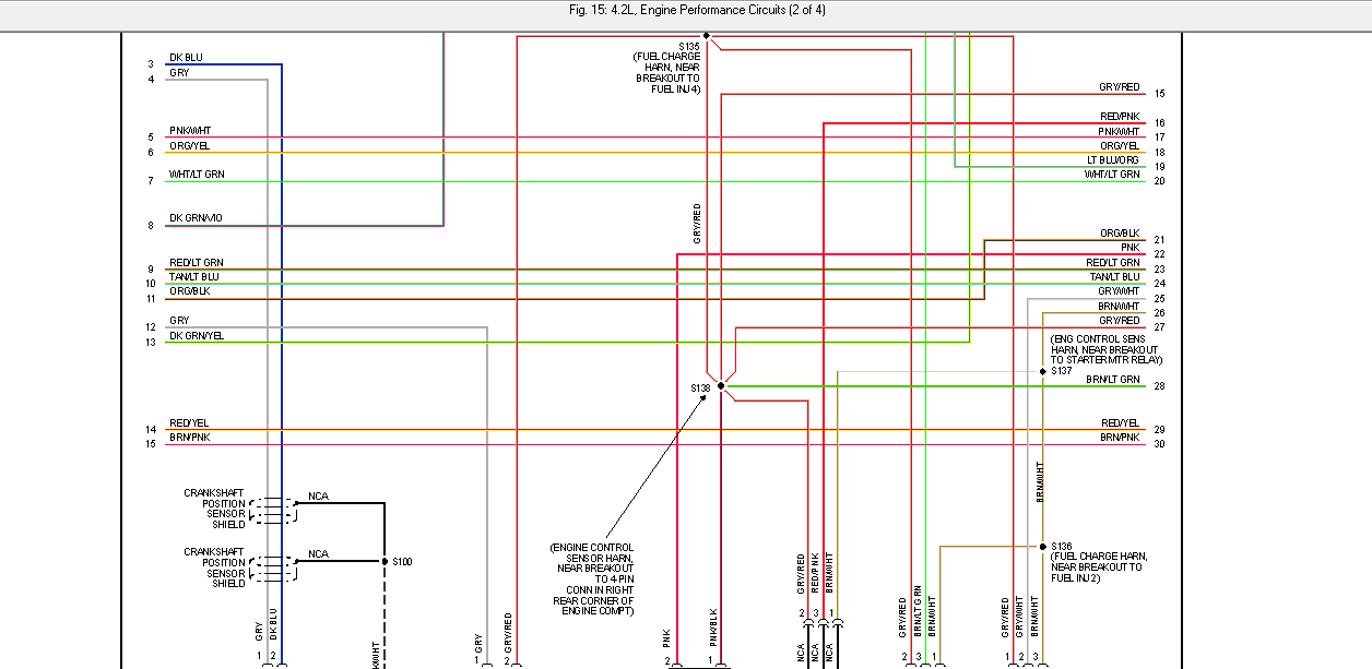

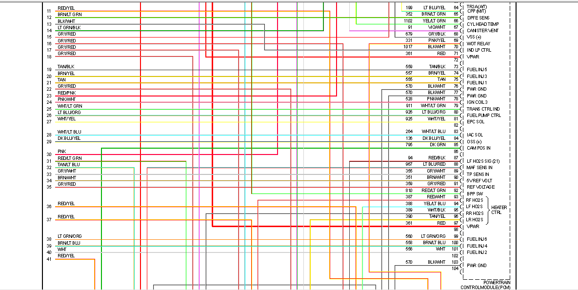

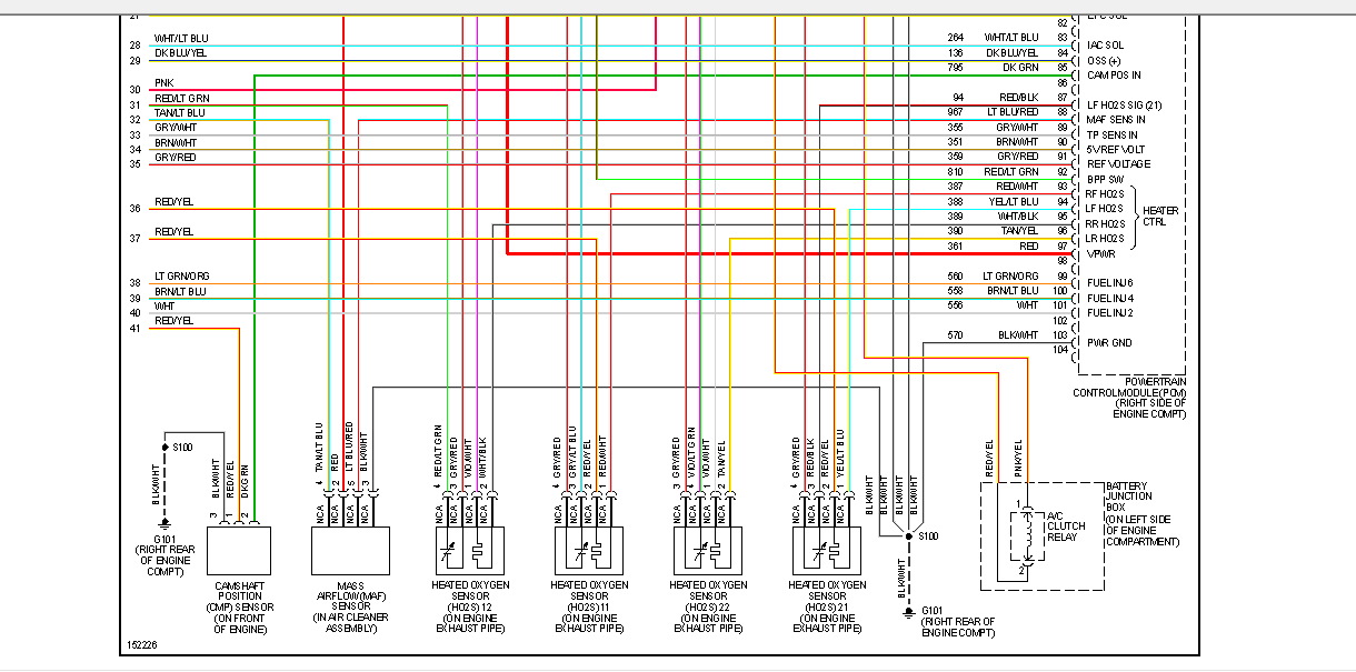

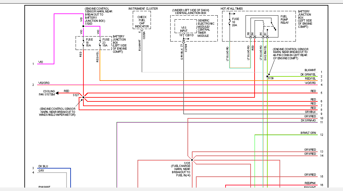

check figures below complete engine wiring diagrams for 4.2L engine, I cut each page for 3 sections to become more clear when reading.
