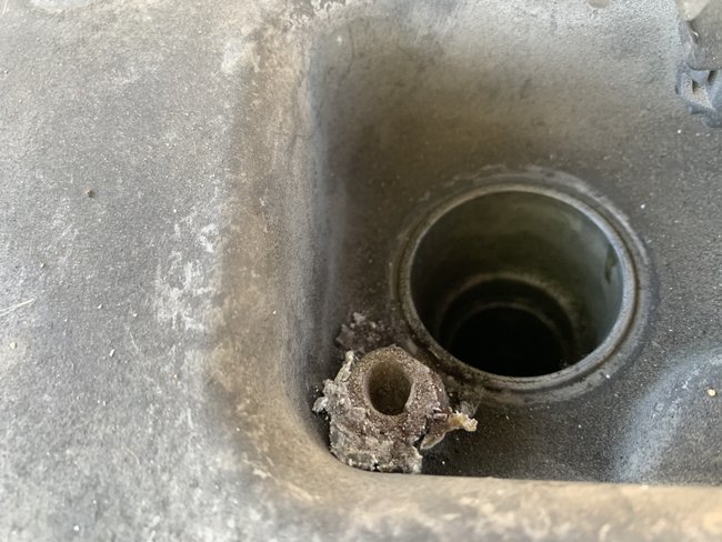

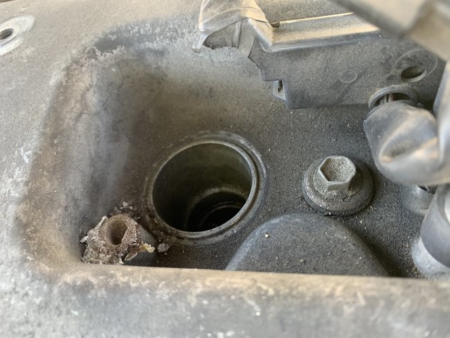

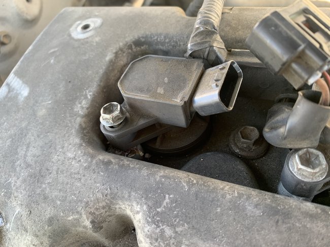

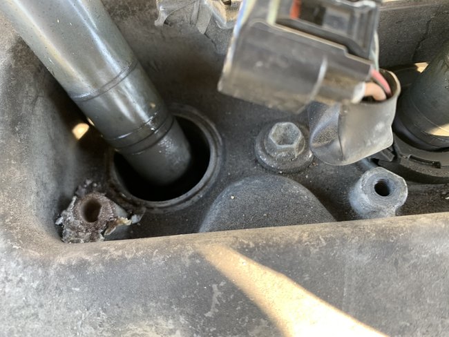

On the far left engine coil, the thread that holds it down is completely stripped away and has practically weathered away. Can the thread be fixed or would it need a completely new valve cover?
Dec 6, 2020 at 5:09 AM
Yes. You can repair this one. That is only holding the coil in place so it does not require any significant strength so the Heli coil will hold it.
Here is a guide on how to do this if you need it:
