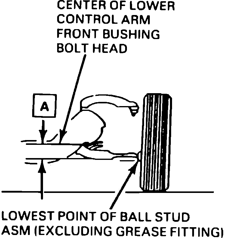

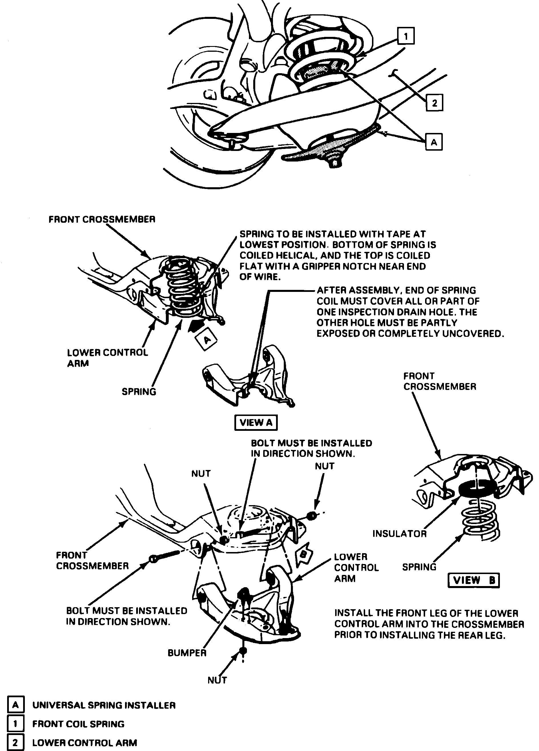

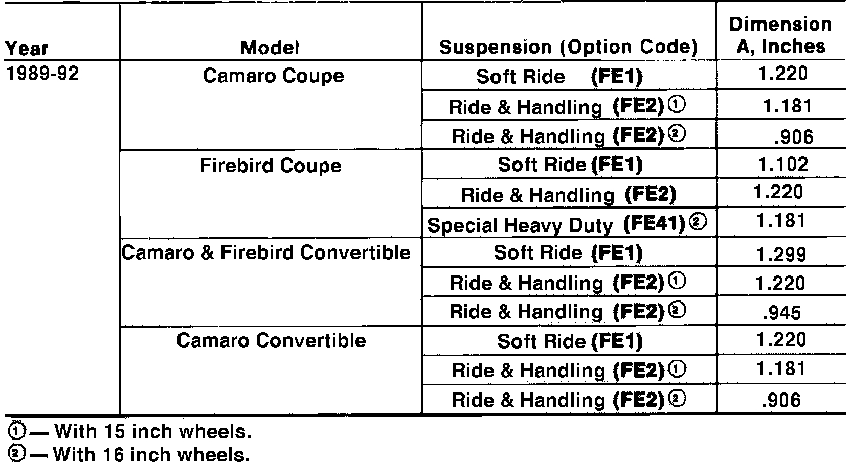

I don't know if you need this, here are the directions for removal and replacement. The attached pics correlate with directions.

FRONT COIL SPRING
Fig. 6 Coil Spring Replace
Pic 1
Fig. 7 Lower Control Arm Dimension A Measurement Location (Part 1 Of 2)
Pic 2
Fig. 7 Lower Control Arm Dimension A Measurement Location (Part 2 Of 2)
Pic 3
1. Raise and support vehicle, then remove wheel and tire assembly.
2. Remove stabilizer link and bushings from lower control arm.
3. Remove cotter pin and nut from tie rod end.
4. Using tool J-24292-B or equivalent, disconnect tie rod end from steering knuckle.
5. Using a suitable spring compressor, compress coil spring, Fig. 6.
6. Remove lower control arm pivot bolt, then pivot control arm rearward.
7. Remove spring compressor and coil spring.
8. Reverse procedure to install. When installing, position coil spring as shown in Fig. 6. Lower control arm must be positioned at dimension A, Fig. 7, when torquing bolts.
