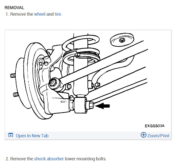

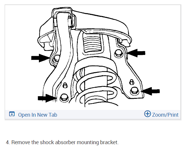

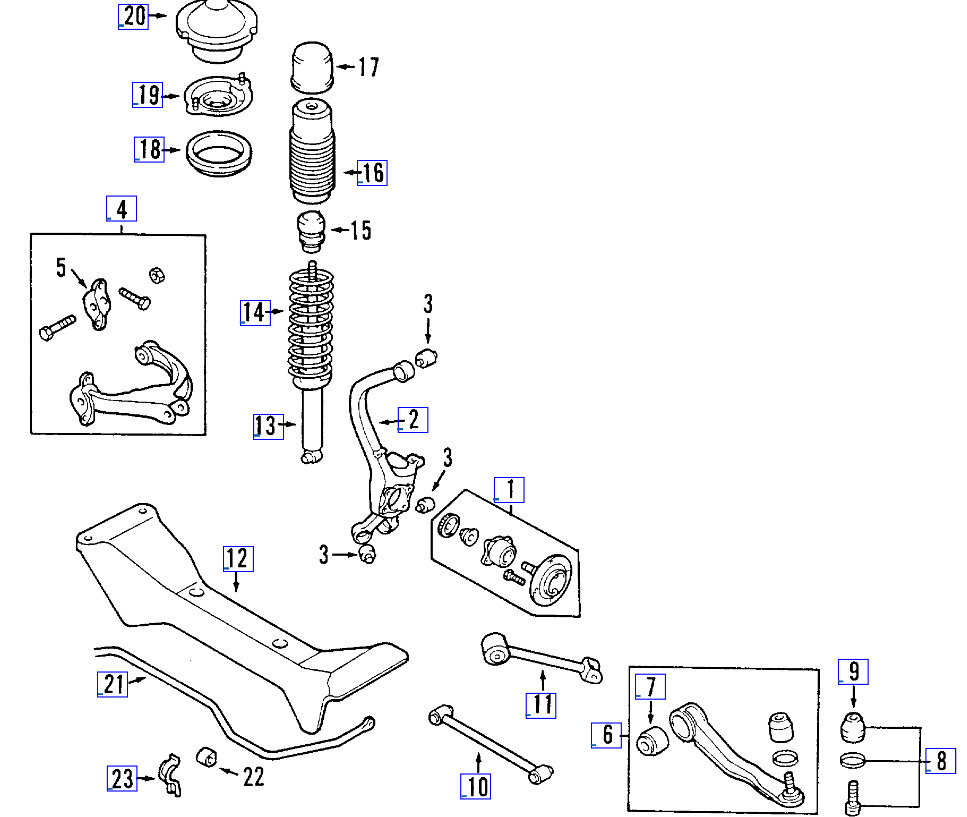

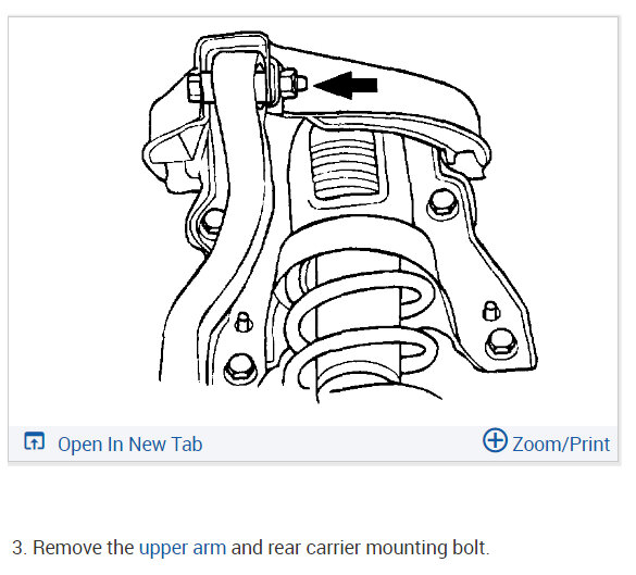

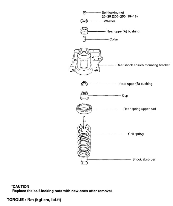

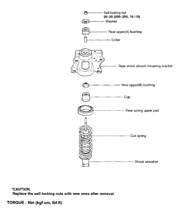

It sounds like you may have the wrong part. Can you please upload an image of the problem? Here is an expanded view of the strut assembly and how to replace the rear struts and coils. Check out the images (below). Please upload pictures or videos in your response to the problem so we can see what's going on.
