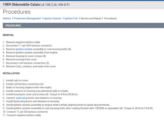

Ignition coil how do I remove and replace?
Jan 18, 2022 at 10:12 AM
  • 110,240 POSTS

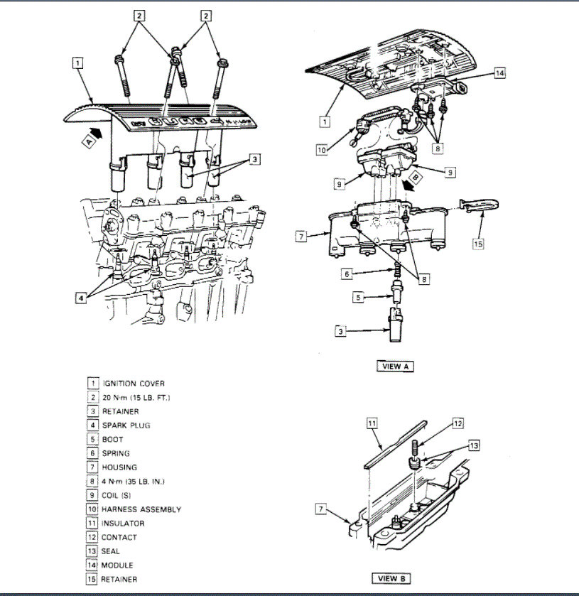

To replace the coil assembly on this vehicle is simple. There will be a few bolts to remove from the assembly, a wiring harness to disconnect, and then it's just a matter of pulling straight up in the assembly for removal.
I attached the very vague directions I have from the manual. I also attached an exploded view of the component so you can see where the bolts are located.
Let me know if this helps. Also, please let me know if I can help.
