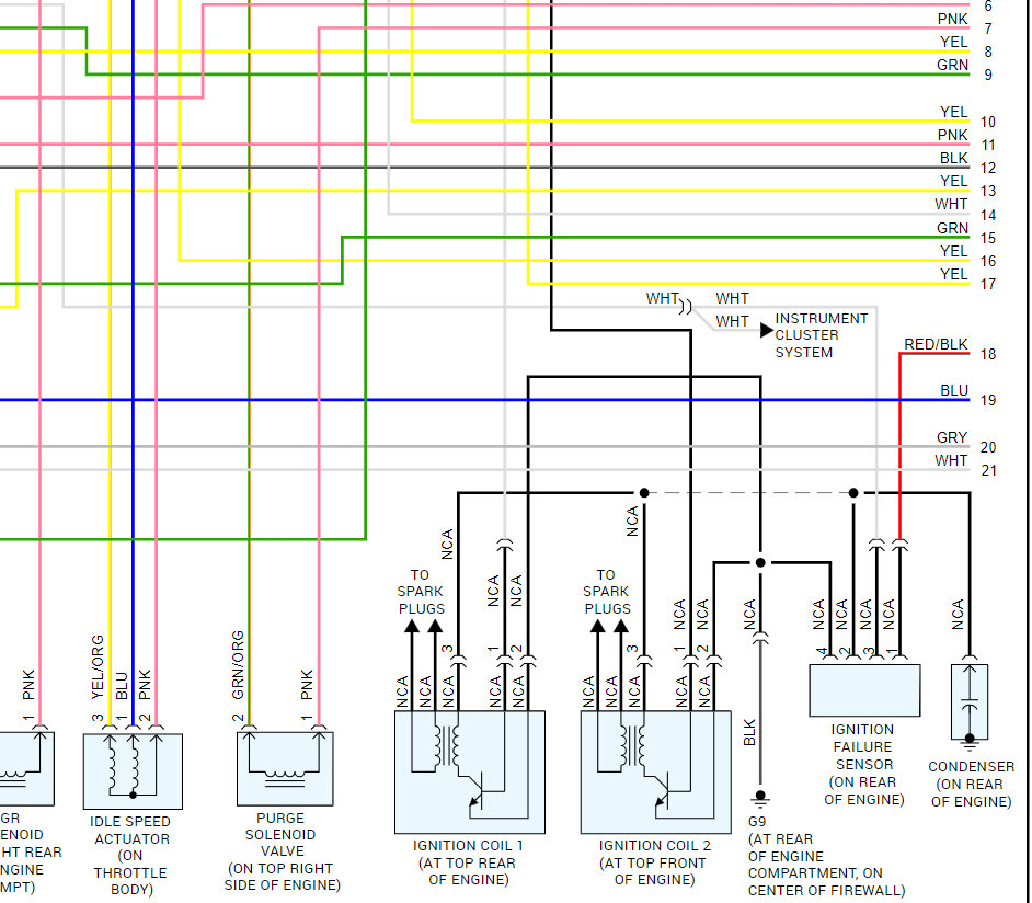

My coil packs wire connector broke ordered new packs and connectors, but the new connector all the wires are black. I don't know how to wire the new ones.
Jul 30, 2024 at 3:55 AM
  • 55,224 POSTS
I would swap the wires one at a time because it looks like the old wires are all black as well unfortunately. Here is what the ignition coil wiring diagrams look like. I don't have a connector view which would have helped, sorry. Check out the images (below). Let us know how it goes.
