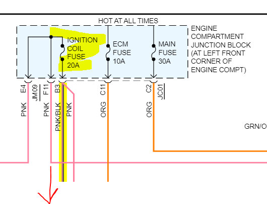

54 years I'm turning wrenches and can't figure out why my coil packs aren't getting any voltage when I try to start it, started when my camshaft sensor pigtail came apart, found new ones on eBay wired it up with the correct readings,12v at the primary wire,5v at the signal to the ECU and ground, every fuse inside and under the hood are ok, I'm totally lost on what else I need to check, replaced the ignition failure sensor, both coil packs, just no current at the coil packs connector plug!!

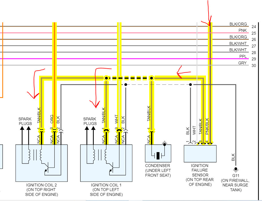

Are you getting power to the ignition failure sensor? Power from the ignition fuse in the under-hood junction box to the failure sensor. From there it is sent to each coil via a tan wire with a black tracer. For the circuit to be completed and fire the coil, the PCM needs to provide a ground path via coil 1 white wire and coil 2 orange wire.
So, if you do have power to the coils but they won't fire, either we have an issue with the PCM or the crankshaft position sensor. Keep in mind, the CKP may or may not set a code if it fails. If you have a live data scan tool, check to see if there is an RPM signal when cranking the engine. If you don't have one, see if the tachometer moves at all when cranking.

Power to the coils should be present with the key on (engine off or on) and in the start position.
Go to the ignition failure sensor. Disconnect the connector and check pin 4 for power and pin 1 for continuity. If you have both, replace the sensor. I believe you replaced it already, but you may have gotten a bad one. If you have power and ground to the sensor, you should see power at the coils unless there is an open circuit between the sensor and coils.

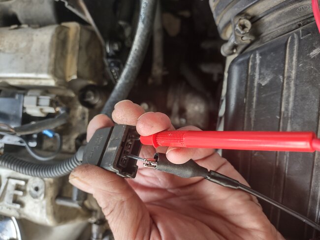

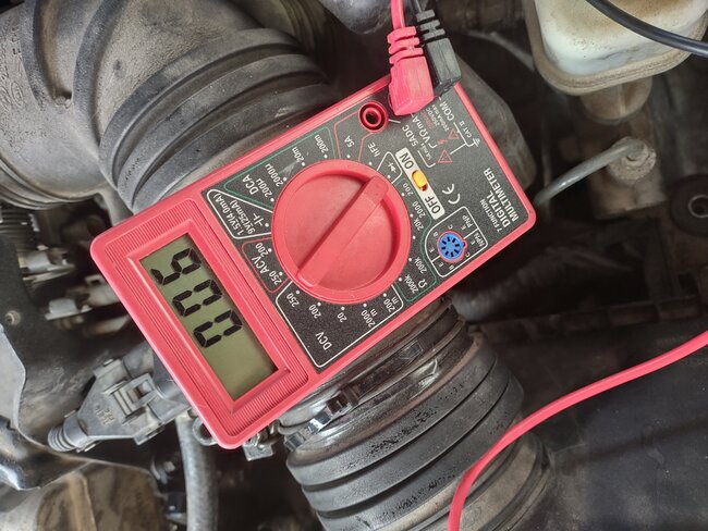

Not sure if you got my last reply,i have 12v to the failure sensor pin 4,pin 1 is in the image i sent,all fuses that lead to the ignition are all working,cranked the engine,no tach reading but still no power at the coils, I'll keep checking back with you to see if can figure something else out, meanwhile I'll keep trying to see on my end, thanks!!!

Looking at your second pic, if you got 12v and used the ground in the connector, you confirmed both are good.
So, connect the sensor and back probe pin 3 (tan/black wire) out of the sensor connector for power. If there isn't any power out, the sensor is bad. If there is and nothing at the coils, then you have an open between the sensor and coils.

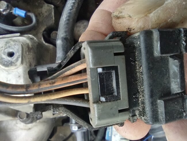

If I'm looking at the plug for failure sensor 3rd wire is just a skinny tan wire, the second one is a + also but power coming from the one next to the 12v which is the top wire, if it's the sensor being a defect I'm going to be really upset with AutoZone but wouldn't be the 1st time, so no power out definitely has to be the sensor??

Meant to say that the second wire which is +v has no power coming out when I back probed it, the 3rd wire is just a skinny tan wire with nothing either, so if I'm not getting anything from back probing it it's definitely the sensor??

According to the manual, that is correct. Let me know if a new one eliminates the issue. However, also make sure the connector is in good condition and nothing is damaged.
The tan/black wire is what sends power to the coils. Make sure the key is on when testing.
