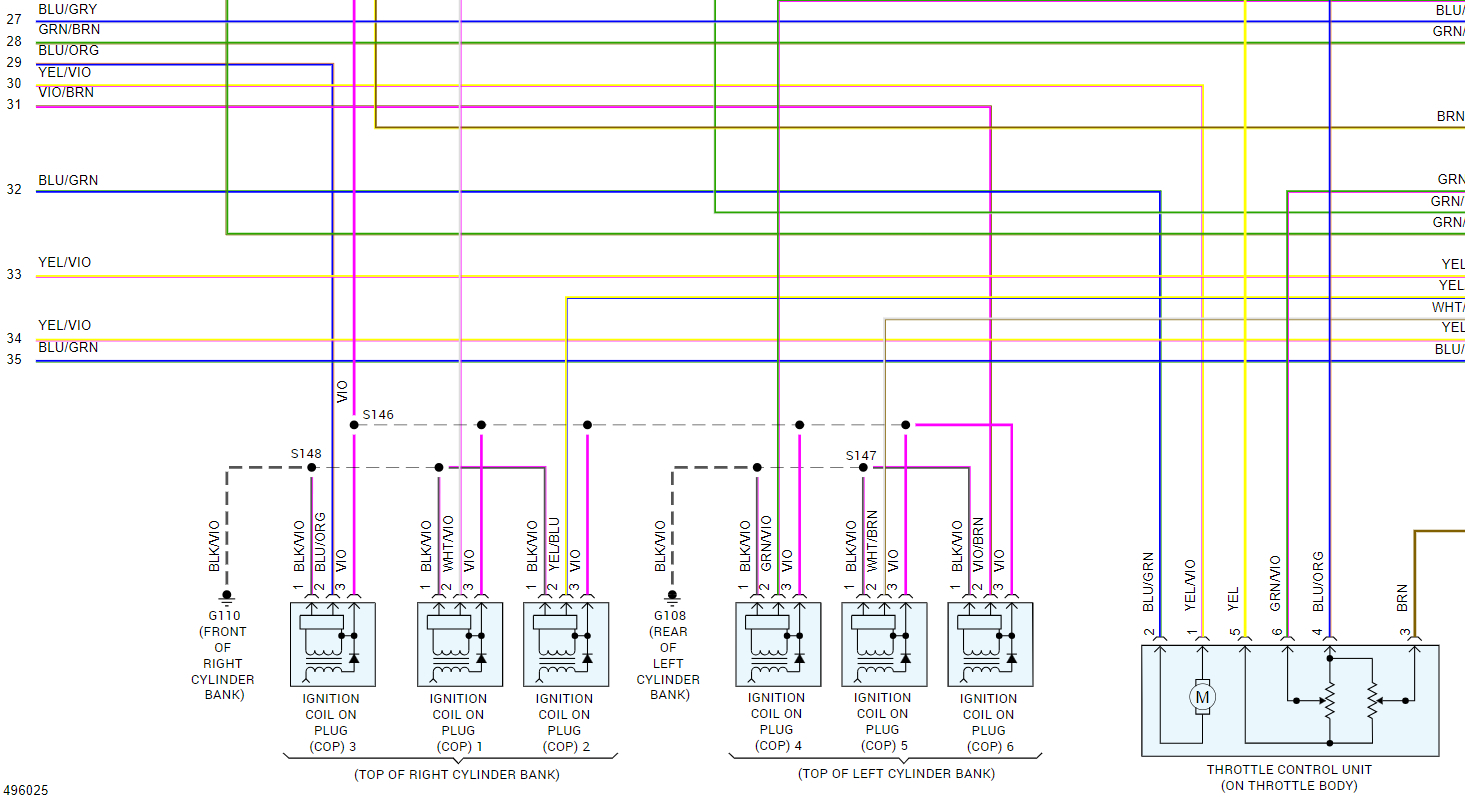

I have lost track of which wire goes in which order on number six 6 coil. I have 2 purple and purple with black stripe.

No problem, here are the wiring diagrams for the ignition coils as requested, check out the images (below). Let us know if you need anything else.

Thank you for the fast response. I will check it out in the morning. To me it looks like two violet wires identical and a violet/black wire. I will let you know. Thanks again

Thanks again for the diagram it helped out.
