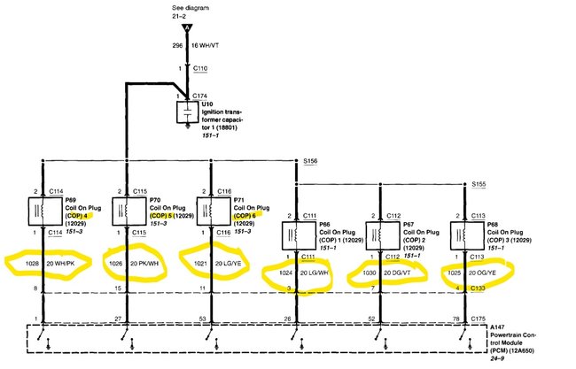

Coil pack wires connected incorrectly; can I get a color-coded wiring diagram for the control wire?

When changing out plugs and coil packs the guy pulled all the wires at the same time on 4,5 and 6 and put them back on wrong. I need the color code for the control wires to 4 5 and 6 so I can put them on the correct coils. The wires coming from the coil driver to cylinders 4,5 and 6 I need the colors of wires.

That's a bit of an oops. Here is the OE diagram, in the event it's hard to read the coil wires are 4 -white with pink trace, 5 -pink with white trace and 6 -light green with yellow trace.
