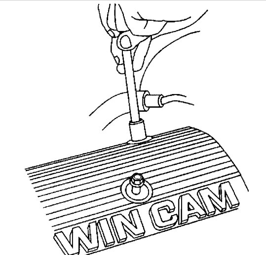

I need to know how to replace my coil pack on my 2001 grand am 2.4l cylinder cause I just can't figure it out.
Oct 1, 2025 at 1:58 PM
  • 55,399 POSTS

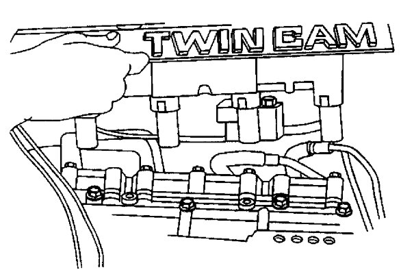

The coil housing is part of the upper engine cover, remove the electrical connector and the mounting bolts and you should be able to lift the coils off of the spark plugs. FYI these go bad all the time so replacing it should get rid of the engine misfire. Check out the images (below). Please upload an image or short videos in your response
