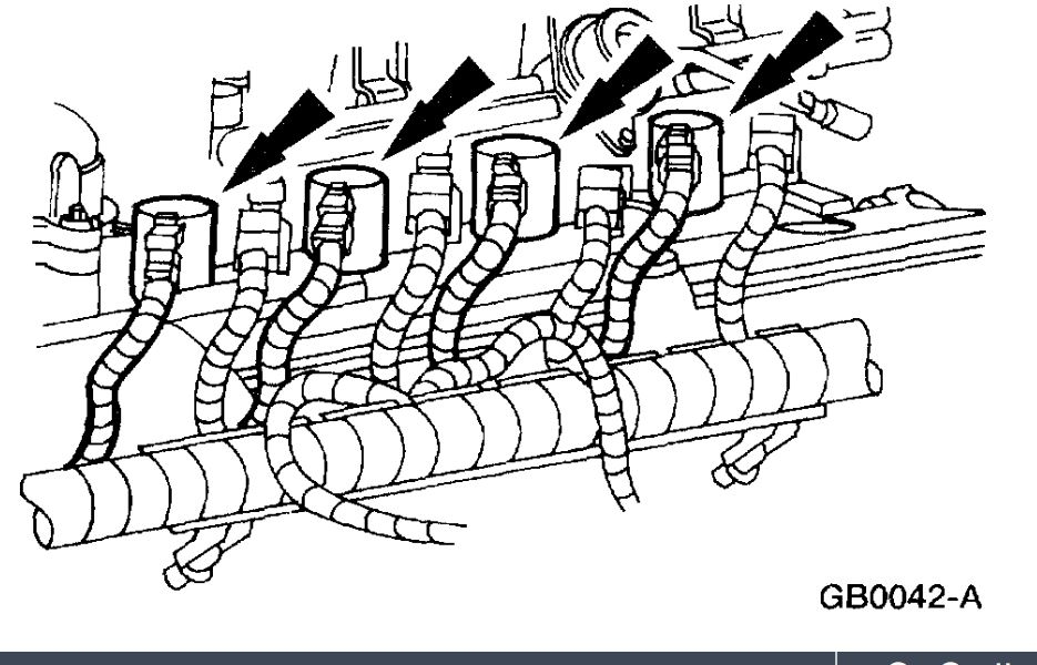

I am trying to remove the plug that goes into the coil pack. Well it is stuck. The clips broke and it will not budge. How do I get it off?
Saturday, December 1st, 2018 AT 7:21 AM
  • 52,797 POSTS
Good morning,
If the clip broke, you will need a small screwdriver with a curved pick end that is small. Then you need to insert it in the end by the coil and pry up the lock to release.
You should replace the pigtail for the coil.
