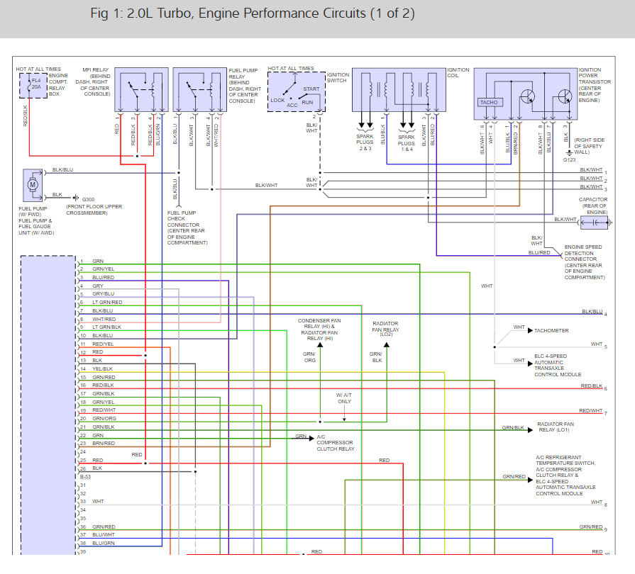

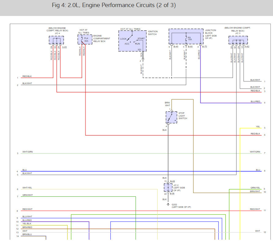

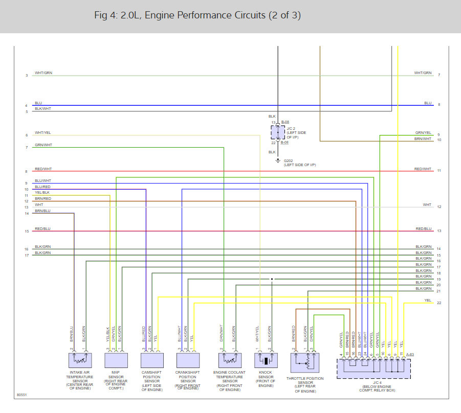

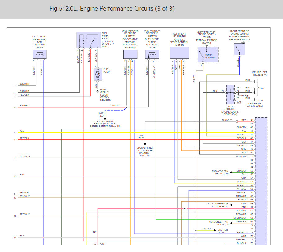

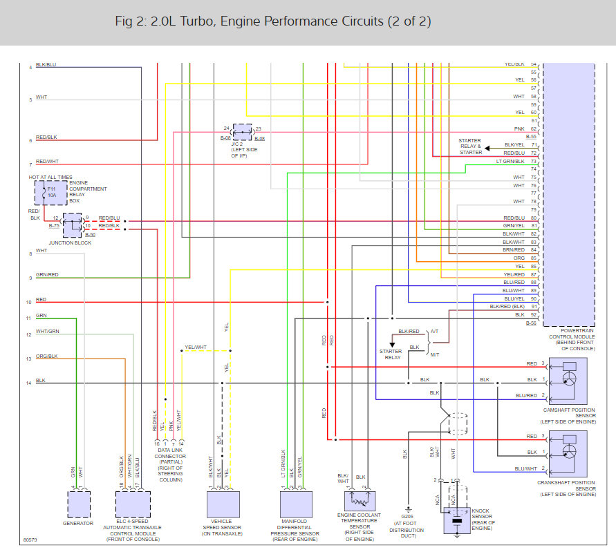

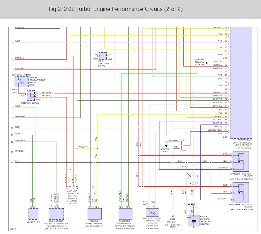

The owner before me for some reason cut off the connector that plugs into the coil pack. All I know it is a 3 pin connector. I just cannot seem to figure out what order they go in.
Oct 14, 2018 at 12:16 PM
DANNY L
  • 5,648 POSTS
Hello, I am Danny.
Just a quick question first. Is it the 2.0, or 2.4 Liter. After hearing back from you I would be happy to provide a wiring diagram. Hope this helps and thanks for using 2CarPros.
Danny-
Oct 14, 2018 at 8:15 PM
96RS
  • 7 POSTS
It is a 2.0.
Oct 15, 2018 at 12:38 AM
  • 55,421 POSTS

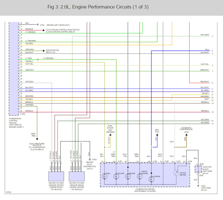

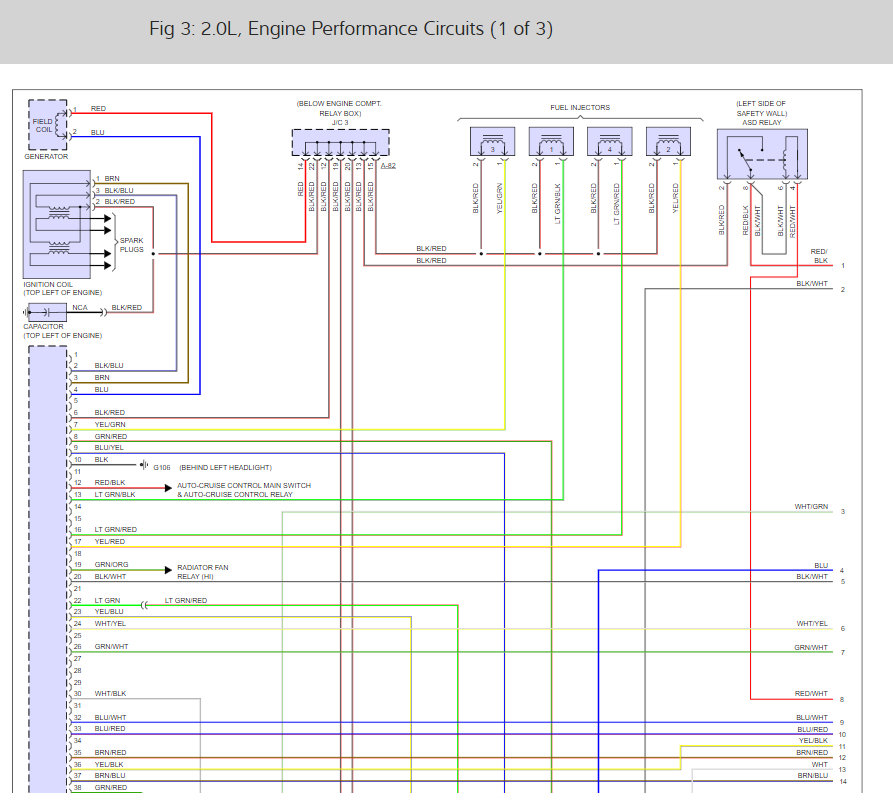

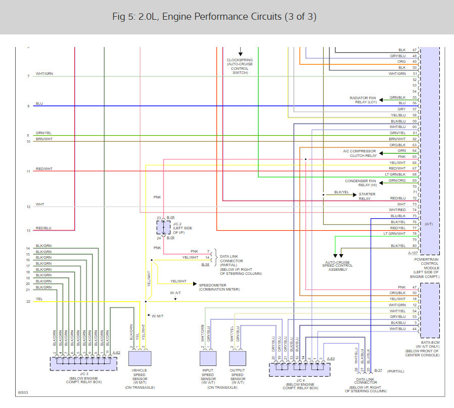

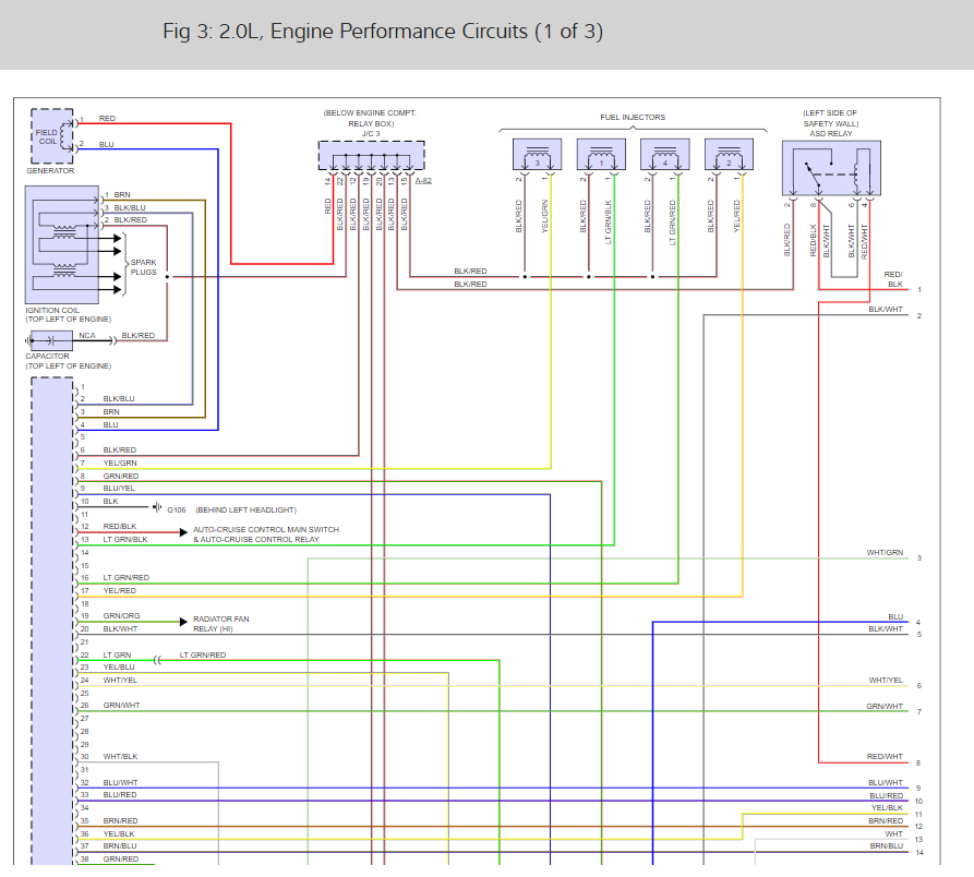

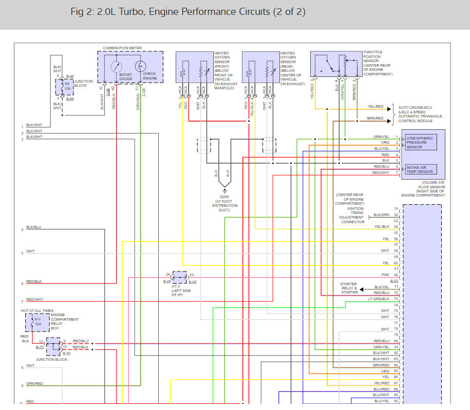

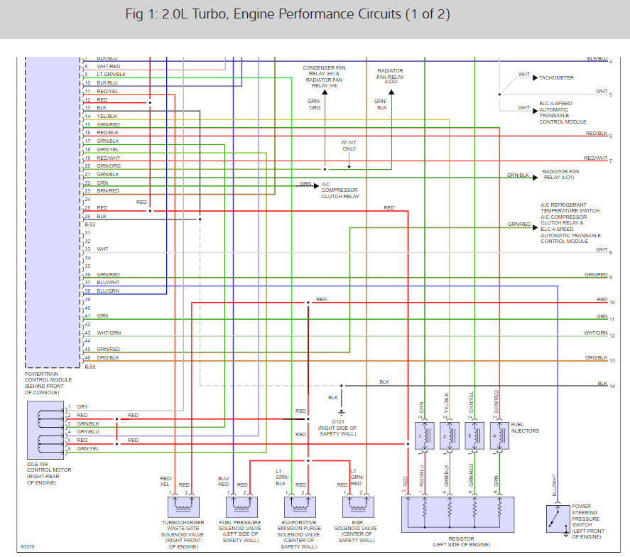

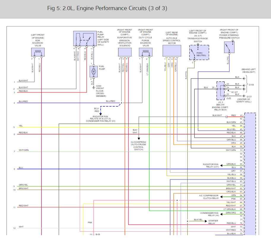

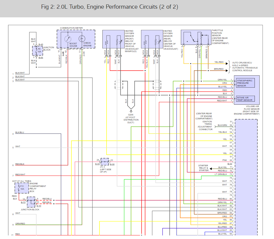

I found you both turbo and non turbo engine wiring diagrams. If you have any problem please upload a video or picture of what you are looking at.
Oct 17, 2018 at 4:05 AM
96RS
  • 7 POSTS
It is a 420a n/t. Which diagram do I use ?
Oct 17, 2018 at 4:43 AM
96RS
  • 7 POSTS

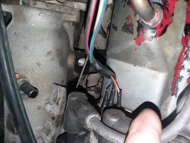

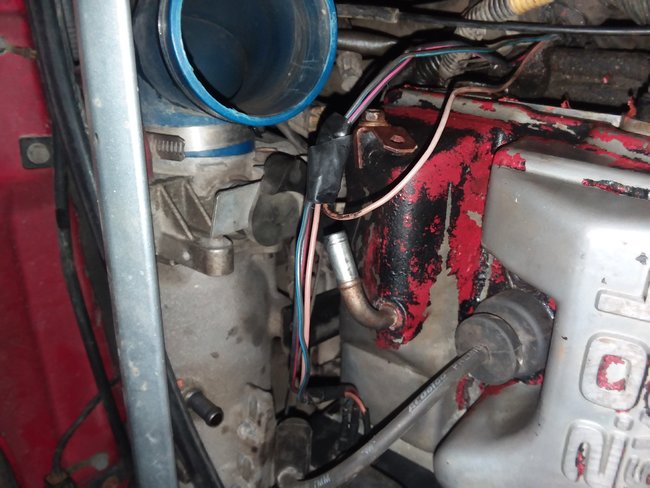

This is the wiring that I have extended.
Oct 17, 2018 at 12:06 PM
  • 55,421 POSTS
Nice work, do you have a turbo? If so use the first set of diagrams of not use the last set.
