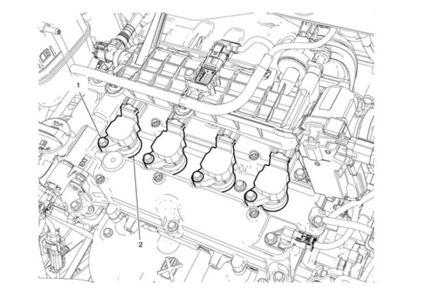

I just need to know which cylinder is cylinder number two. Had a code p0302 which means misfire in cylinder two. While looking at the engine. From the top. Does the cylinder go 1234 or 4321. Basically which one is cylinder 2?
Dec 28, 2018 at 12:07 AM
Good morning,
I attached a picture for you to view. cylinder 1 is marked for you.
it goes 1-2-3-4,
