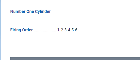

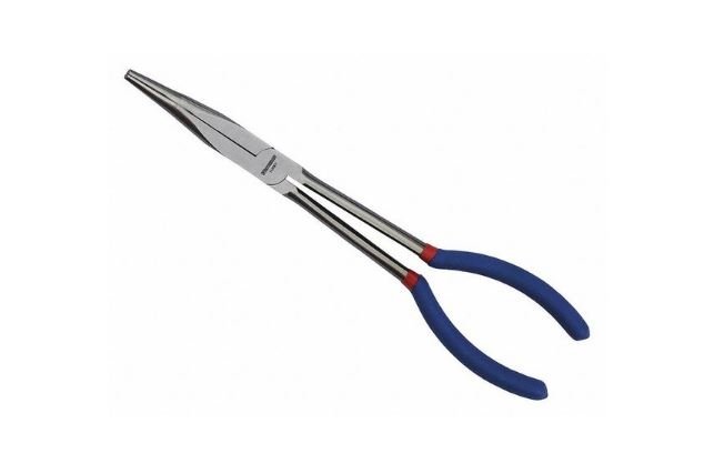

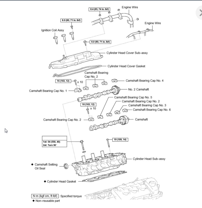

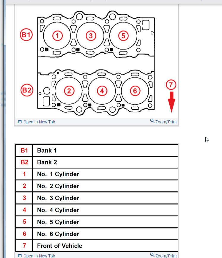

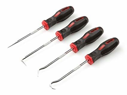

It broke in half in the spark plug tube. tube is still good but there is a small part of the coil pack stuck in the tube. How do I get it out to fix it?

Hello, probably the easiest way would be to use a pick to dig into the plastic and pull the pieces out. Or a set of long needle nose pliers. Check out the diagrams (Below). Please let us know what happens.
Oct 29, 2019 at 8:54 PM
I agree with Steve that you will want to use something to reach in if possible. Other wise you are going to have to take the valve cover off in order to reach down in there and get it out.
I am attaching the info for this. Let us know if you have other questions. Thanks
