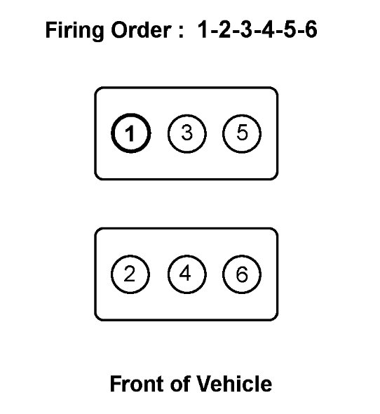

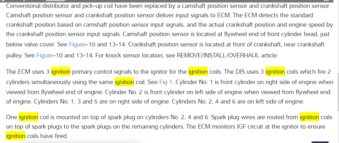

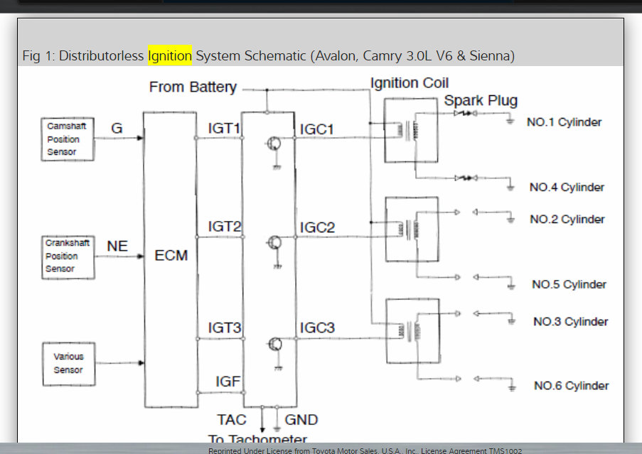

Where is number 5 and 6 at on the engine? is 5 on the back? Is there a coil pack or wire?
May 20, 2019 at 6:46 AM
SCGRANTURISMO
  • 4,897 POSTS
I have included all the information that you requested in the diagrams down below. It consists of a description of your vehicle's ignition system as well as diagrams of it. Please go through the information and get back to us with how everything turns out.
