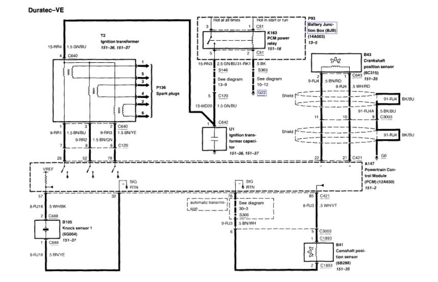

I am trying to determine if the coil pack on this car has gone bad or not. I was running then quit. I check the wiring found there was no power getting to the coil pack.
I checked the harness and found a harness connector had partially come loose, so I reconnected it and made sure it was locked together. I rechecked the coil pack
and it has power going to it once again, but the car still will not start. I have seen some YouTube videos showing ohm tests being done, but I just want to make sure before
spending money to replace it. the general ohm readings I have found, I have used to compare to the ones I have gotten from this coil pack. At the connector they seem high at 2.9 ohms on the 200 ohms setting and at the plug wire terminals seem to be in range at 10.5 ohms on the 200K ohms setting. from what I understand at the connector it is supposed to be between 0.5- 2.0 ohms and at the plug side it is supposed to be between 8.0- 19.0 Kiliohms.

I am sorry, but I guess I did not explain myself very good. I have the coil pack off the
car right now performing an ohms test on it, because supposedly you can determine
if a coil pack is bad or not with an ohm meter through a resistance test at both the
wire connector plug and at the plug wire terminal towers. now according to
NGK there are resistance value ranges for both the wire connector plug and the
plug wire terminal towers that can be used to determine whether or not a coil pack is
bad or not, which is what I stated before. I got power reinstated back to the coil pack, but I
also check the other three wire pins at the coil pack wire connector that go to the three individual coils inside the coil pack itself and they each had power to them as well with
the key in the on position only. Now with all that said I did try to start the car, but it just
cracks but will not start. I even pulled a spark plug wire from the coil pack and checked for a spark
at the tower nun present. that is why I pulled the coil pack to check for resistance to see
if it is bad. Supposedly it can be done. I am thinking the wire connector terminal on the
coil pack is bad, or primary circuit. Because the secondary circuit seems to be in range
according to NGK's measurements anyway.

Okay, I have never relied on the ohms test. it only checks part of the coil not all of it.
if you have voltage to the coil, make sure the return wire to the pcm is not broken or corroded.
did you have spark when you tested it with the plug attached?
if you have a tachometer on the dash, does the tachometer move up a little when cranking? that will tell us if the crank sensor is sending a signal.

Okay, I can do that I just need to determine what color code that is so I can follow it back to the PCM. As far as the spark plug I never checked with a spark plug, I checked with a test light. No spark. I am solo figuring this out. I changed out the crank censor, but no I did not pay attention to the tachometer like I should, my fault. I will reinstall the coil pack and check those two areas and see what happens. PCM return wire and tachometer and go from there. Thanks
