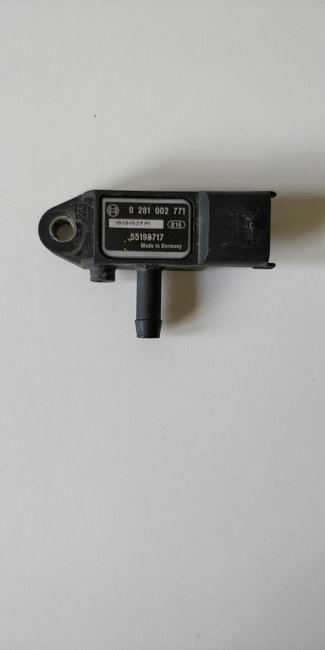

The DPF pressure sensor on my car (image attached) has two inputs but only one of them (the long input) is connected to the DPF; the other (the short input) measures atmospheric pressure. Hence, in my case, the DPF pressure sensor is measuring the pressure inside the DPF relative to atmospheric pressure. The readings of this DPF pressure sensor that I quoted in the previous post were from a new pressure sensor that was fitted after the coil light started flashing (based on advice from my mechanic).
After reading forums, I have understood that the ECU computes soot levels using two methods - the measured method - where the ECU computes soot levels based on differential pressure i.e. based on the readings of the DPF pressure sensor and the other method - the calculated method - is where the ECU calculates the soot level based on parameters (other than the differential pressure) such as, maybe, miles driven, fuel consumed, lambda sensor readings etc.
First of all, is this two method determination of soot levels which I have explained correct?
Secondly, if it is correct, how does the ECU know when to base soot level determination on the measured method instead of the calculated method?

Okay. Our systems differ a little bit but this type of DPF sensor is used on other types of systems. So the way it calculates the soot level is actually a combination or both methods. Basically they are a check on each other. The vehicle runs a calculation on how much soot it should be producing and then it measures the soot load based on this sensor. They work very much like a check and balance. This way it will set some codes if they are not lining up with each other.
This is the way the systems work here so I am sure this part of the system is no different over there. It is pretty standard. It is called redundancy which will cut down on a vehicle running too long with faulty DPF system.
